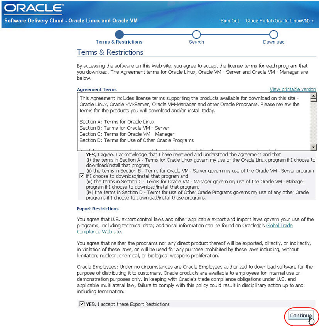

Download the Linux Installer Media Pack
Use this procedure to download the Linux installer media pack from the Oracle Software Delivery Cloud website. The media pack is delivered as a compressed ISO image file, which you can extract and write to portable media of your choice.
Note – Before performing this task, you must obtain an Oracle Software Delivery Cloud user ID and password from your Oracle support representative.
Note – You must perform this procedure on a system that has network connectivity, a Web browser, and a method for writing to external media, such as a DVD burner or a USB port to connect a flash drive.
Note – You must only obtain Oracle Linux from the Oracle Software Delivery Cloud website.
1.
http://edelivery.oracle.com/linux
2.
3.
4.

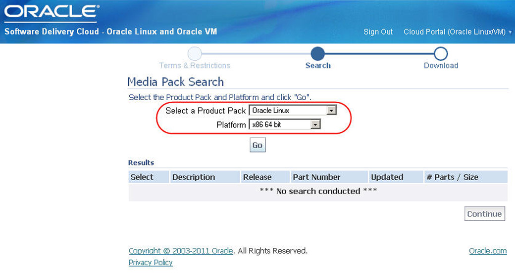

a.
b.
c.
5.
a.
b.

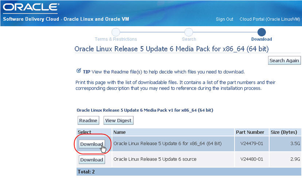

Note – STA requires the 64-bit Linux version. During STA installation, the installer will check for this requirement.
c.
6.
Note – For Linux version requirements, see “Operating System Requirements”.
7.
8.
Depending on network speed, this may take around an hour.
9.
10.
You will use the media to install Linux on the STA server.
