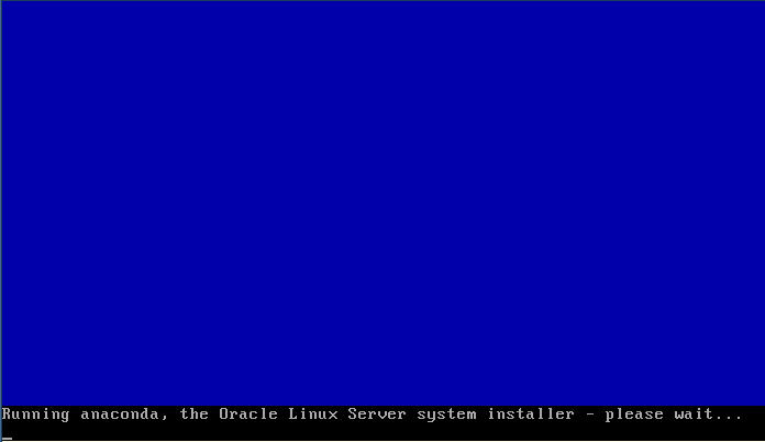

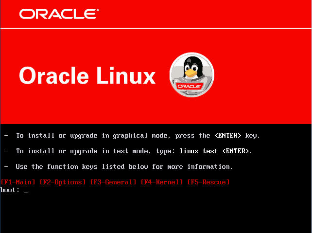

You will see a series of messages as the installer probes your system. This process may take a minute or two.
4.
a.
b.

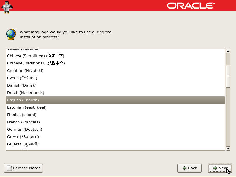

An information screen appears as the installer starts up. This process may take a minute or two.
5.
Note – You can view the Linux release notes by clicking the Release Notes button.

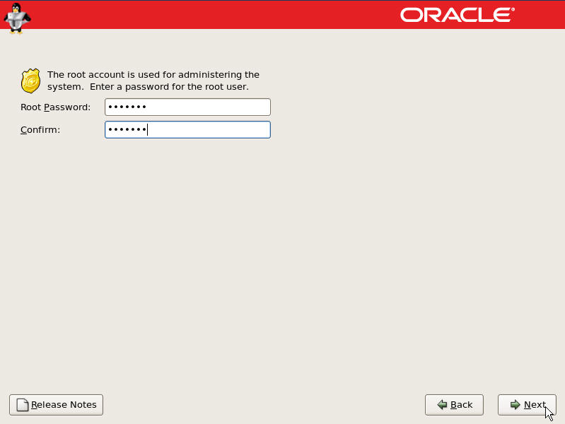

11.
Note – The root user has complete access to the STA server.

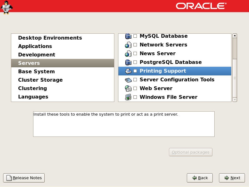

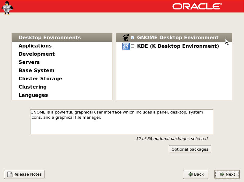

15.
a.
Note – The STA installer will check for the glibc-devel package (part of the Development Libraries group) and the rpm-build package (part of the Development Tools group). If these are not present, STA installation will fail.

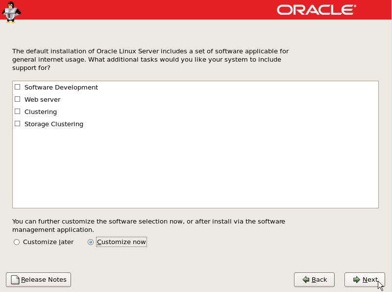

16.
a.
b.

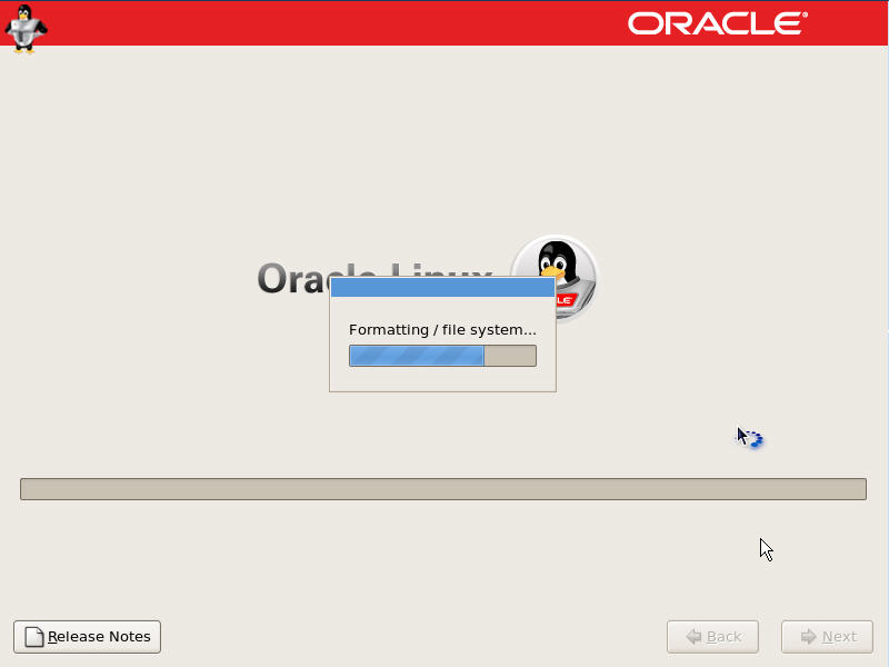

Depending on your specific server configuration, installation may take around 30 minutes.

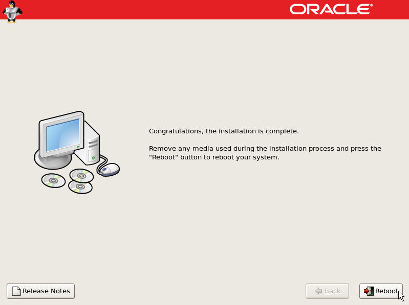

24.
The graphical installer terminates, and the server reboots.
Note – Once the server reboots, you can view a complete log of your installation in /root/install.log.
