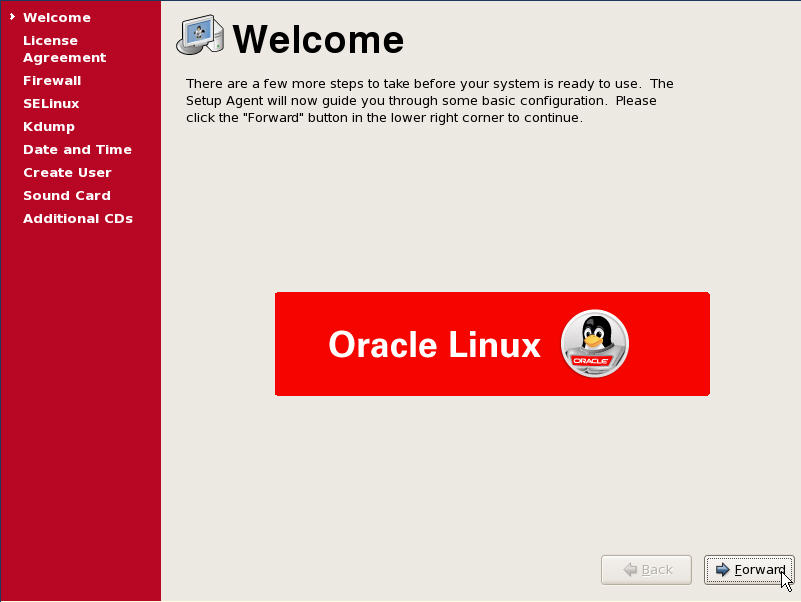

The Linux Setup Agent starts automatically when you reboot the Linux server.
Note – The examples in this procedure use the graphical setup agent for OEL 5u6. If you are installing a different version of Linux or if you are using console mode, the exact steps may vary.

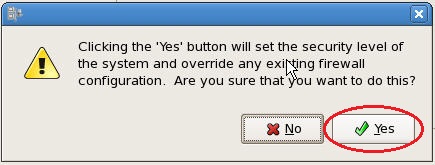

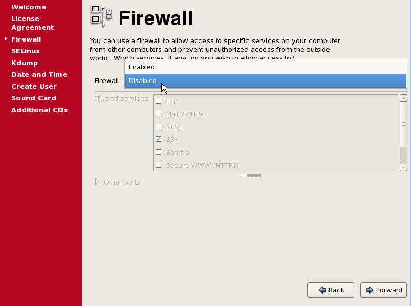

Note – This is the recommended setting for the STA server. However, you may choose to enable and configure a firewall depending on the requirements at your site.

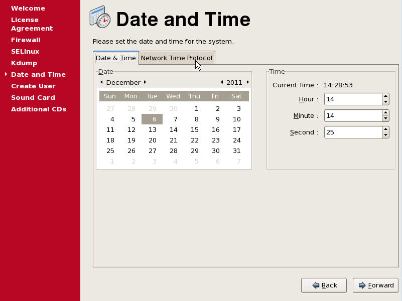

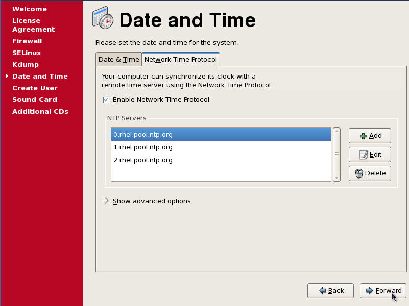

Note – To ensure that STA data and log files are correct, the date and time on the STA server must be correct. Additionally, any library connected to STA must also have the correct time.

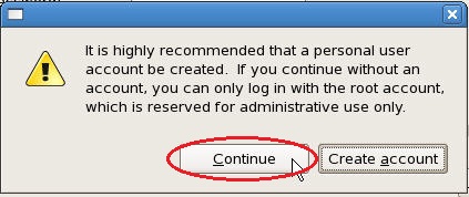

The STA server does not require a non-administrative user. If you want to add one, you can do so at a later time.

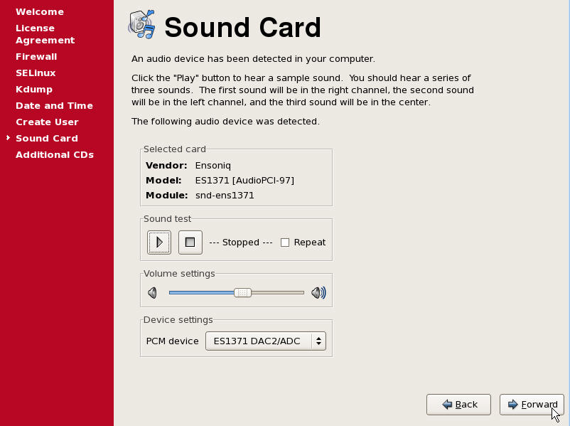

STA does not require sound.
