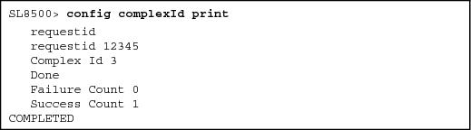

For each SL8500 library that will be monitored by STA, use the following command to display the complex ID currently assigned:

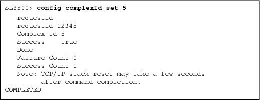

config complexId set complex_ID
Where:
complex_ID is the new complex ID; a number 1–253.
