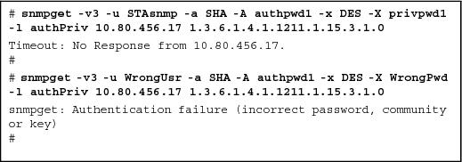

Example of Unsuccessful Commands

If the command was successful, proceed to “Log In to the STA User Interface”. If the command was not successful, contact your network administrator or Oracle support representative. You can also view the troubleshooting information in “Troubleshoot an Unsuccessful SNMP Connection”. You may need to troubleshoot issues with packet routing between the library and the STA server.
