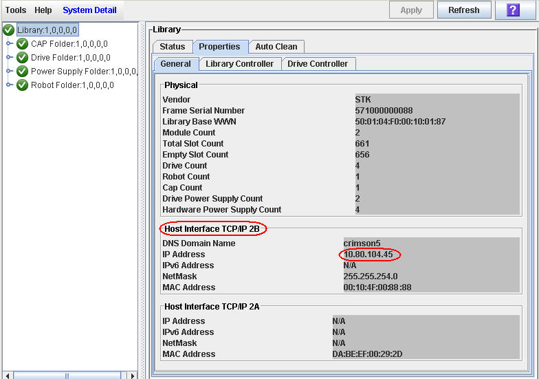

Retrieve SL3000 or SL8500 IP Addresses
Before performing this procedure, you must determine whether you want to configure STA to support either Dual TCP/IP or Redundant Electronics, which are optional features for the library. See “Support for Dual TCP/IP and Redundant Electronics” for details.
Note – You must perform this procedure from the SL Console.
1.
2.
3.
a.
Select System Detail > Library > Properties > General.
The IP address information is displayed in the Host Interface TCP/IP 2B and 2A sections.
Note – If the library also includes the Redundant Electronics feature, the IP addresses displayed are for the active controller card only.

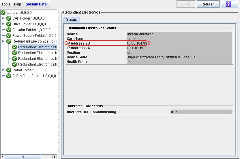

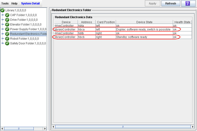

Select Tools > System Detail, and select the Redundant Electronics folder.
Note – If this folder is not listed, the Redundant Electronics feature is not available on the library.
b.
One library controller card indicates “Duplex: software ready, switch is possible”. This is the current active controller and could be either the hbca or hbcb card.
These entries indicate that the controller cards are functioning normally. If either entry does not match, then contact your Oracle support representative before proceeding.

Repeat Step c and Step d for the alternate (standby) controller card.

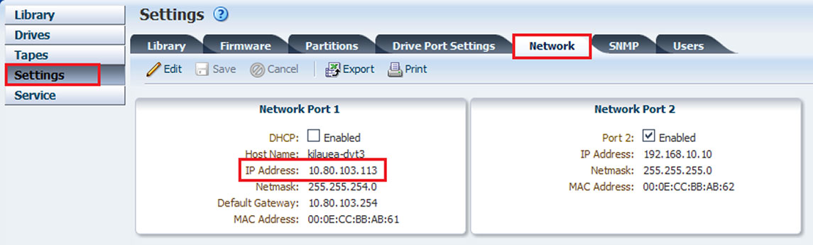

Retrieve the SL150 IP Address
1.
2.
3.
The library IP address is displayed under the Network Port 1 section. (The Network Port 2 section is reserved for service use.)
Note – DHCP should not be enabled. A statically-assigned IP address is recommended for communications with STA.
