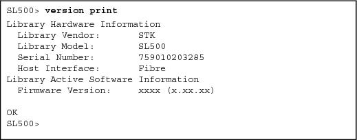

With the CLI (SL500 Libraries Only)
1.
Note – If the screen displays SYNTAX ERROR!!, the library firmware is down-level. Contact your Oracle support representative to upgrade the firmware.

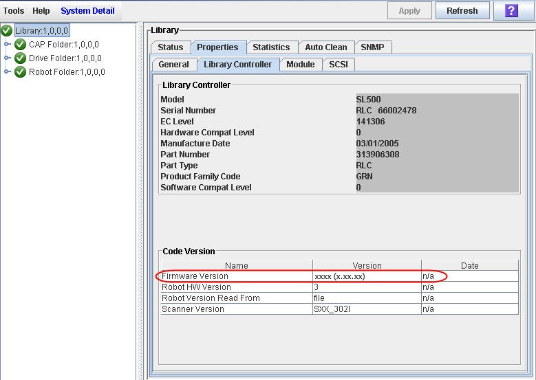

With the SL Console (All libraries except SL150)
1.
2.
Select System Detail > Library > Properties > Library Controller.

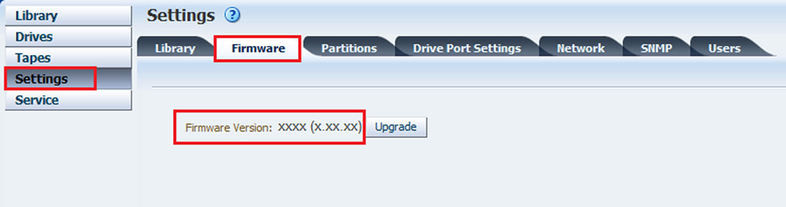

With the SL150 User Interface
1.
2.
3.
The firmware version is displayed.
Note – Alternately, you can click the About button in the lower-right corner of the screen to obtain the firmware version.
