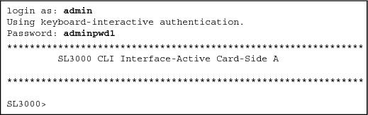

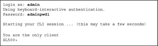

With the CLI (all libraries except SL150)
1.
2.
3.
SL3000 Example

SL500 Example

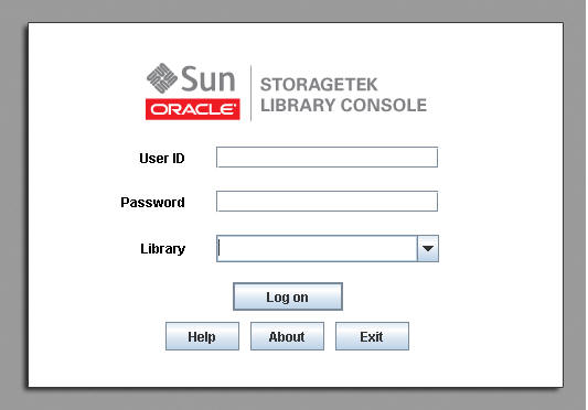

With the SL Console (all libraries except SL150)
1.
Start the SL Console application on your PC or workstation.
The Login screen appears.

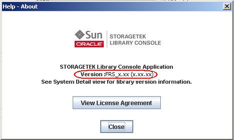

Click the About button to display the current SL Console version and verify that it meets the STA minimum requirements.
Note – If it does not, you must install the proper version before proceeding. See the library User’s Guide for detailed instructions.
3.
Click Close to return to the Login screen.
4.
User ID: admin
Password: password
Library: library_ID
where:
password is the password assigned to this username.
library_ID is the library to which you want to connect, expressed in either of the following ways:
5.

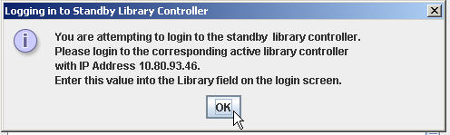

Note – For SL3000 and SL8500 libraries in which the Redundant Electronics feature has been installed and activated, you can only log in to the active controller. If you attempt to log in to the standby controller, the following error is displayed. You must retry, using the correct library ID.

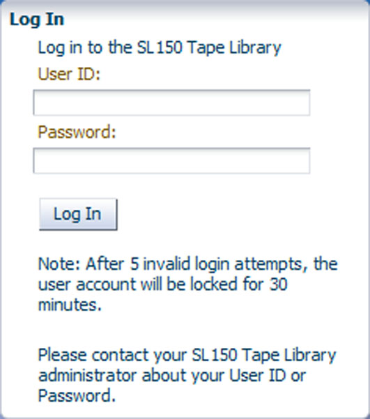

With the SL150 User Interface
Log in to the SL150 browser-based user interface as follows:
1.
Note – If this is your first time navigating to the library, you will be prompted to allow your browser to accept the connection.
2.
Note – The User ID must have the role of administrator.
3.
4.
