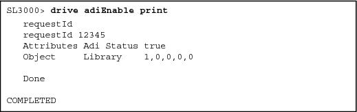

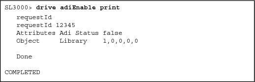

For SL3000 or SL8500 Libraries
1.
drive adiEnable print
2.
3.
Reboot the library to activate the change. See the “SL Console Diagnostics and Utilities” chapter of your library User’s Guide for instructions.
