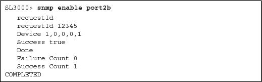

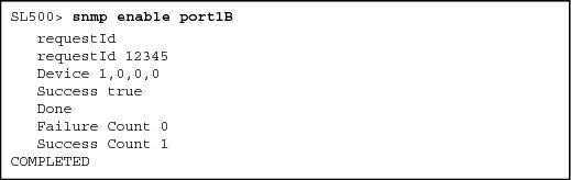

With the CLI
1.
Note – If the library includes the Dual TCP/IP feature, this command enables SNMP on both the 2B and the 2A port; you do not need to issue a separate command for the 2A port.

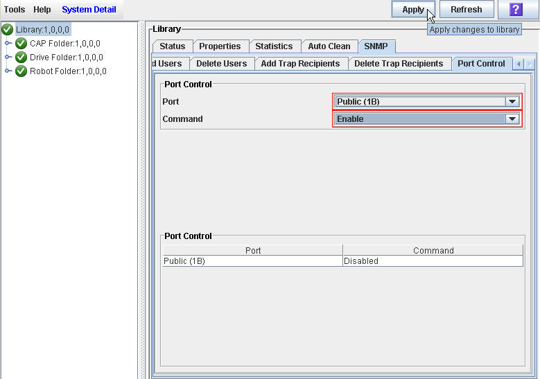

With the SL Console (SL500 only)
1.
Select System Detail > Library > SNMP >Port Control.
2.
Port – Select Public 1B in the menu.
Command – Select Enable in the menu.

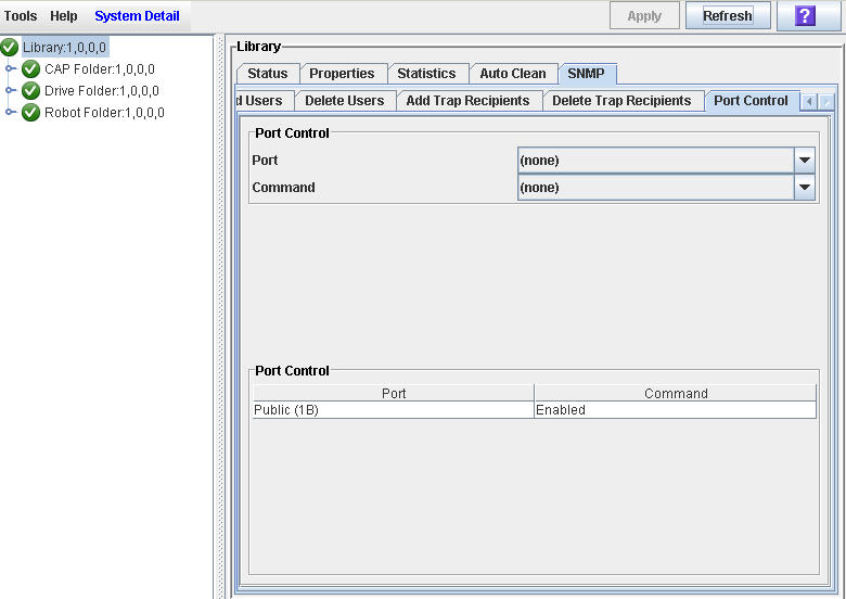

3.
SNMP is enabled on the port, and the status is updated.

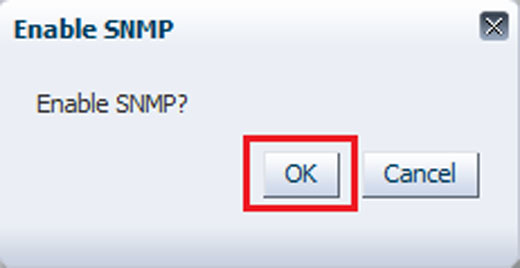

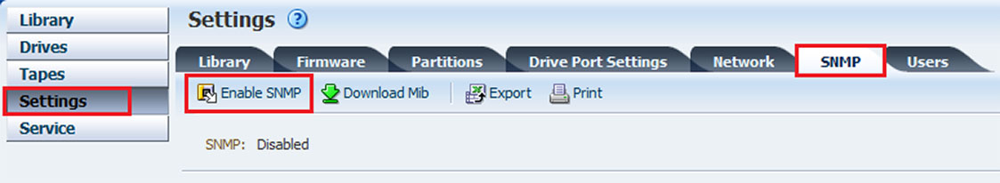

With the SL150 User Interface
By default, the SL150 library ships with SNMP disabled. To enable SNMP, perform the following.
1.
2.
3.
4.
5.
