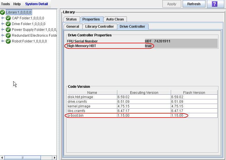

Use the SL Console to verify that a high-memory drive controller (HBT) card is installed in the library and that the card has the correct code version. Without a high-memory HBT card, the library will not supply richer drive data to STA from StorageTek and LTO drives. In addition, you will not be able to enable the ADI interface on the library if you have LTO drives. See “Drive ADI Interface” for additional information.

1.
Select Tools > System Detail > Library > Properties > Drive Controller.
The screen displays details about the drive controller (HBT) card.
2.
“u‑boot.bin” is listed in the Code Version table.
If High Memory HBT indicates “low” or the “u‑boot.bin” entry is missing, then contact your Oracle support representative.
