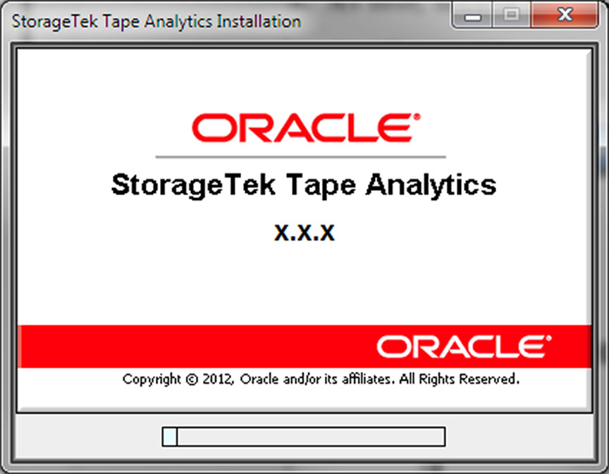

# ./install

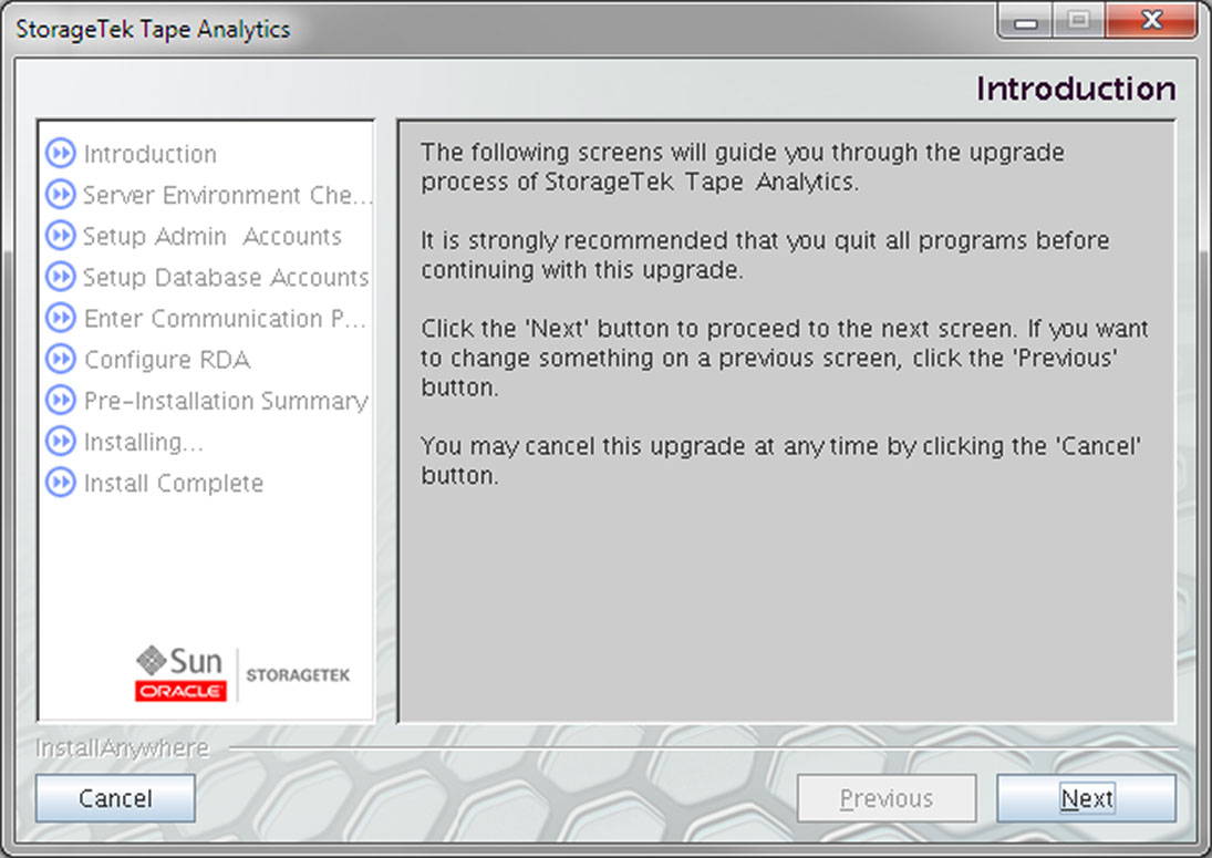

4.

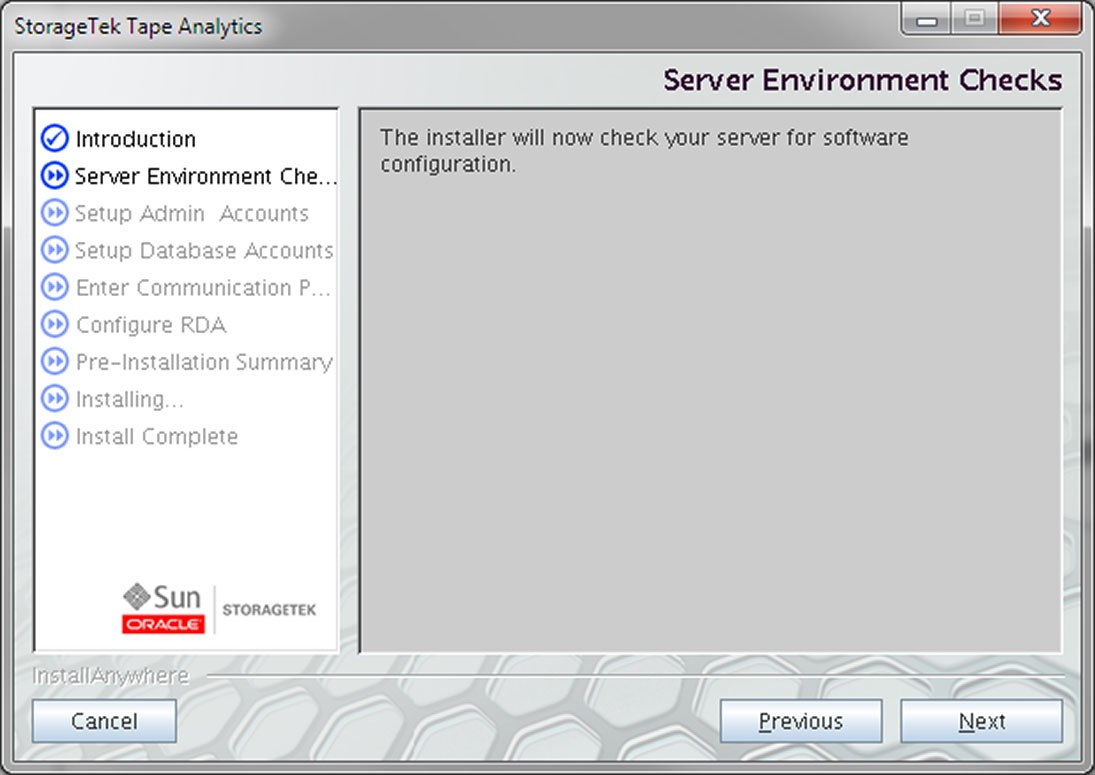

5.

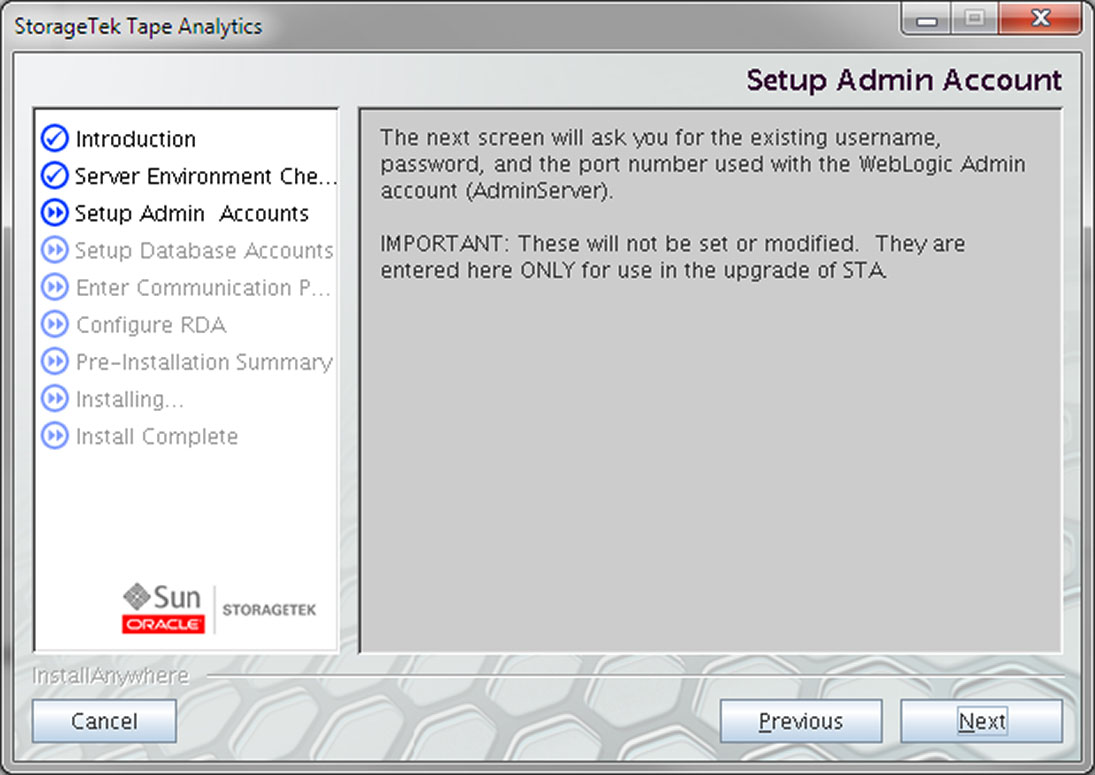

6.
Note – If you receive any messages relating to your environment, see the “STA Pre-Installation Checks” section of the StorageTek Tape Analytics Planning and Installation Guide before proceeding.

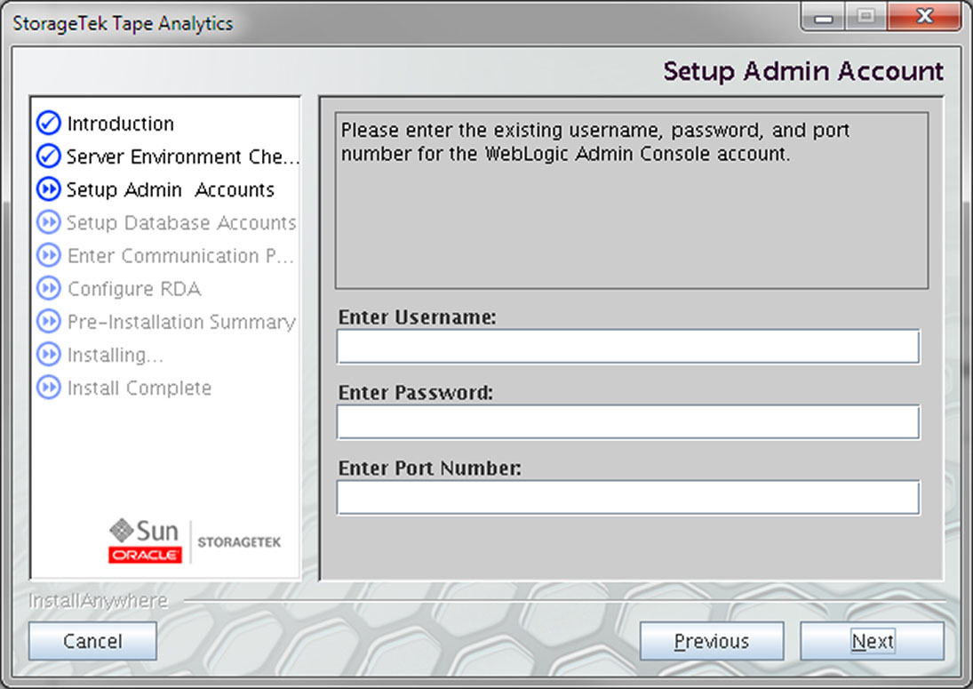

7.

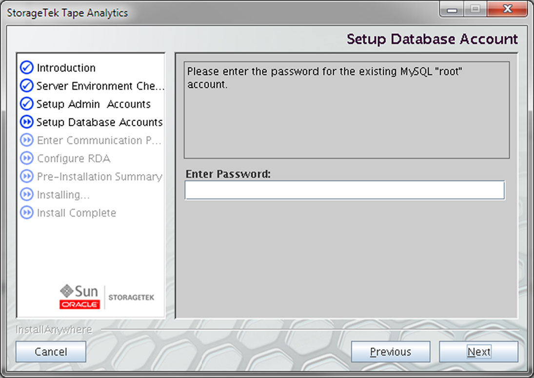

8.
The installer will test the supplied information.
9.
10.

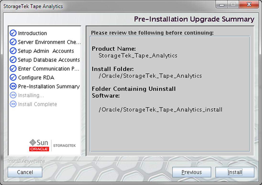

11.
You’ll see notices indicating the progress of the STA upgrade.
Note – Depending on the size and type of data in the STA database, the upgrade process can take as long as 30-60 minutes.

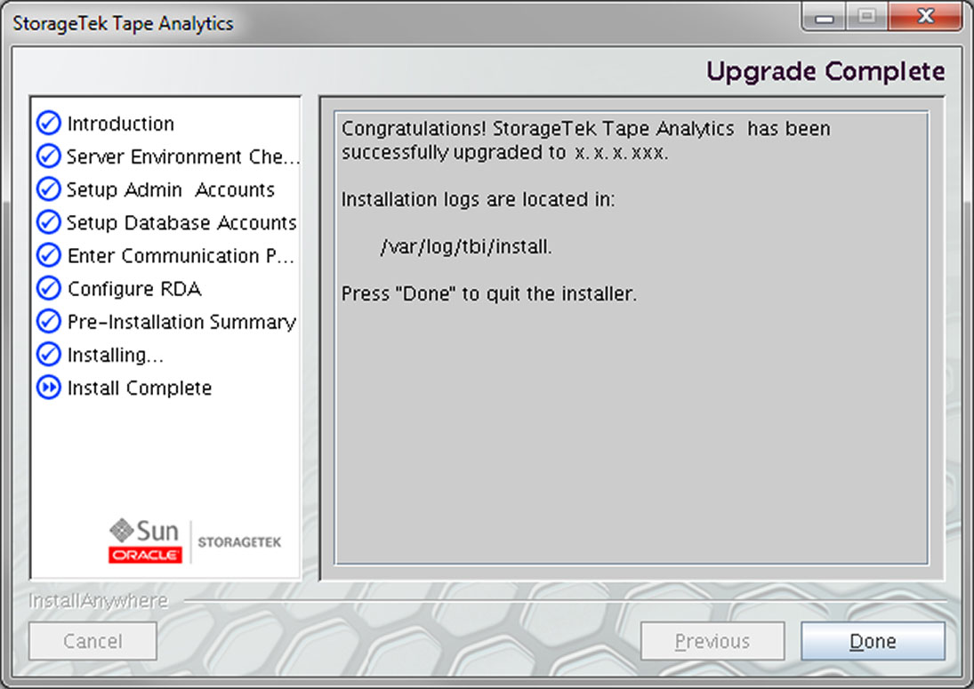

13.
Note – For more information about the STA command, see “Server Administration”.
# STA status
14.
