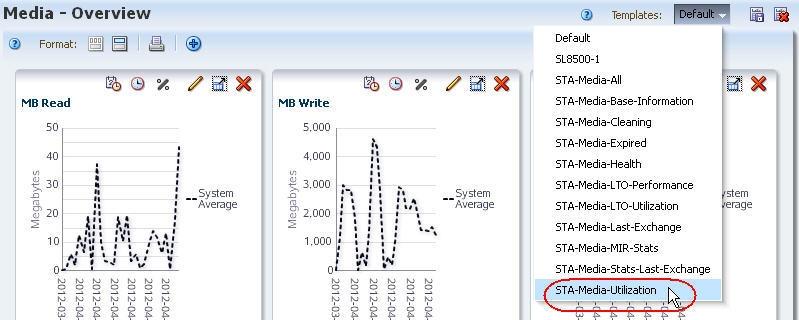

This template includes the “Media MB Available” and “Media MB Capacity” attributes.
