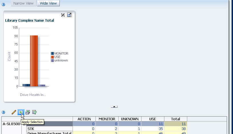

Use this procedure to graph detail data for a pivot table attribute. This results in just one graph pane in the Graphics Area.
Note – You can graph attributes that appear on the row edge only, and only one row at a time. If you select a column edge attribute, or if you select multiple rows, you will see the error, “Please select one and only one row.”
1.
Note – In this example, the “HP” value for the Drive Manufacturer attribute is selected.

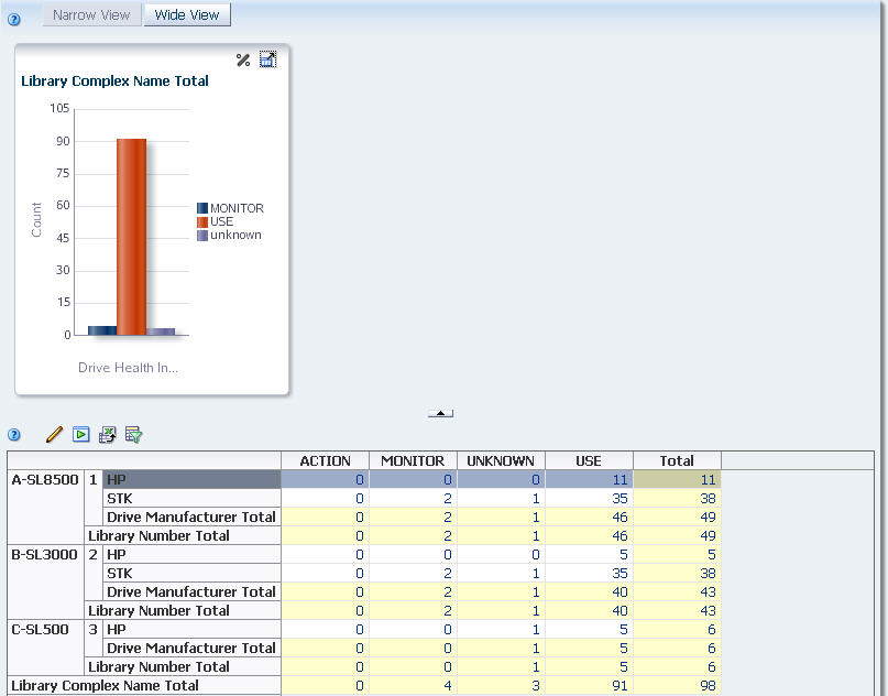

2.
The selected attribute value is displayed in a single graph pane.
