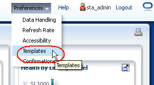

1.

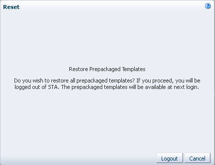

The template Reset dialog box appears.

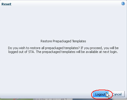

2.
You are logged out of STA and the Logged Out dialog box appears.
