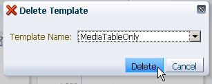

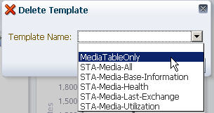

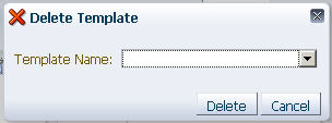

The Delete Template dialog box appears.
2.
3.

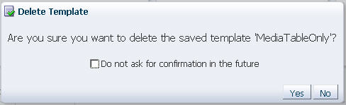

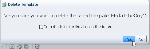

The Delete Template confirmation dialog box appears.
Note – This dialog box does not appear if it has been turned off. See “Modify Confirmation Dialog Box Preferences” for details.
4.
The template is deleted and is no longer displayed in the Templates menu.
