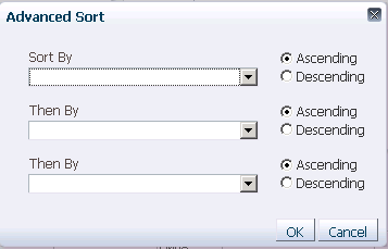

Advanced Sort
Sample Screen
Description
This dialog box allows you to specify a nested sort on a List View table, using up to three columns. You can use any available table attributes for the sorts, even if the attributes are hidden from the current table display.
This dialog box appears when you select View > Sort > Advanced from the List Table Toolbar.
Screen Fields
Sort by
In the menu, select the attribute you want to use for the primary sort. The menu displays all available attributes for the table, including those that are currently hidden.
Then by
This field appears twice. In the menu, select the attribute(s) you want to use for up to two additional nested sorts.
Ascending
Click to indicate that you want the associated attribute to be sorted in ascending order.
Descending
Click to indicate that you want the associated attribute to be sorted in descending order.
Buttons
OK
Click to apply your entries.
Cancel
Click to dismiss this dialog box without applying your entries.
