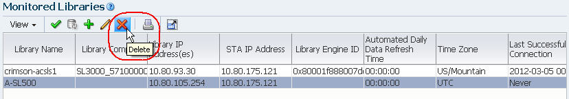

Use this procedure to remove a library SNMP connection. The library will no longer be monitored by STA. All existing data for the library will be removed from the STA screens; however, the data will be retained in the STA data store as a historical record.
After performing this procedure, you can delete the STA SNMP trap recipient from the library. See “Configuring the Libraries for STA” in the STA Configuration Guide for instructions.
1.
2.
A confirmation dialog box appears.

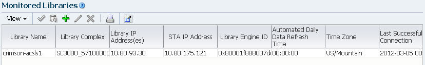

3.
The library is removed from the Monitored Libraries table, and all associated data for the library is removed from the STA screens.
