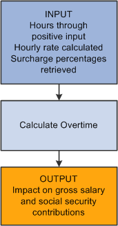

Overtime in the Pay Process Flow
This diagram illustrates how the overtime functionality, from entering hours to overtime calculation, to output of gross salary and social security contributions, fits into the overall pay process flow of PeopleSoft Global Payroll for Spain.
The PeopleSoft Global Payroll for Spain overtime process flow
