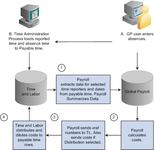

What Happens When You Start a Pay Run
During the Calculate phase of a pay run, Global Payroll retrieves payable time that's ready for processing from Time and Labor. The first time that the Calculate phase runs, Global Payroll processes all payees that are identified in the current calendars. During subsequent runs, Global Payroll creates an iterative trigger and a retroactive trigger for each instance of payable time that has changed and reprocesses only the payees that are in error or have iterative triggers. Payable time is retrieved each time the payroll is run.
After a pay run is finalized, you start an update process that updates the payable time entries in Time and Labor. This process also invokes the Labor Distribution and Labor Dilution processes in Time and Labor, if you have elected to use those features. If you are not using labor distribution, Global Payroll sets the status of payable time entries to CL (closed).
The following flowchart illustrates the interactions between Global Payroll and Time and Labor:
Integration between Global Payroll and Time and Labor
Note. Absence data that is sent to Time and Labor is not used to compensate payees for absences. Global Payroll calculates payee compensation for absences, and when the labor distribution feature is used, sends the resultant amounts back to Time and Labor after a pay run is finalized.

The Update process:
Updates the payable status for each entry that was set to SP:
CL with a reason code of Not Distributed if the entry was processed, but the Labor Distribution feature is not enabled in Time and Labor.
RP with a reason code of Not Processed if the entry was retrieved but not processed.
This status applies when payable time is not processed by Global Payroll. This can result from a user manually entered positive input for the same earning or deduction element. Manually entered positive input always takes precedence. This can also occur if the employee is not eligible for the earning or deduction or if the payee was cancelled from the payroll.
Returns the original Time and Labor sequence number for each payable time entry along with the corresponding cross-reference numbers that Global Payroll generated during the bundling process.
The cross-reference numbers tell Time and Labor which entries were bundled, making it possible to link the costs that were calculated for earning and deduction to the daily detail.
If the Labor Distribution feature in Time and Labor is enabled, sends cost data that is associated with payable time entries to Time and Labor.
If Labor Distribution is enabled but Labor Dilution is not, the labor distribution amount and diluted labor distribution amount sent by Global Payroll are the same.
If Labor Distribution and Labor Dilution are activated in Time and Labor, Global Payroll sends the Labor Distribution Amounts to Time and Labor and invokes the Labor Dilution process.
