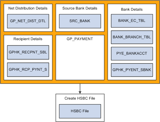

Click to jump to top of pageClick to jump to parent topicUnderstanding the EFT HSBC File
The Hong Kong-standard HSBC file for EFT is created by a process that provides multiple options that control what each file contains. You can create an EFT file that contains:
The following diagram shows the tables that contribute data to the HSBC file that is part of the EFT file:
Tables contributing data to the HSBC file
Note. You must finalize your banking process (GP_PMT_PREPARE) before you can create the HSBC file. After the HSBC file has been created, the system changes PMT_STATUS on GP_PAYMENT from P (prepared) to T (transferred).
