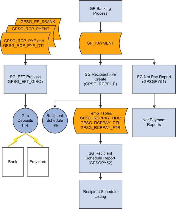

The following diagram shows the process flow for banking and recipient processing:
Banking and Recipient Processing
