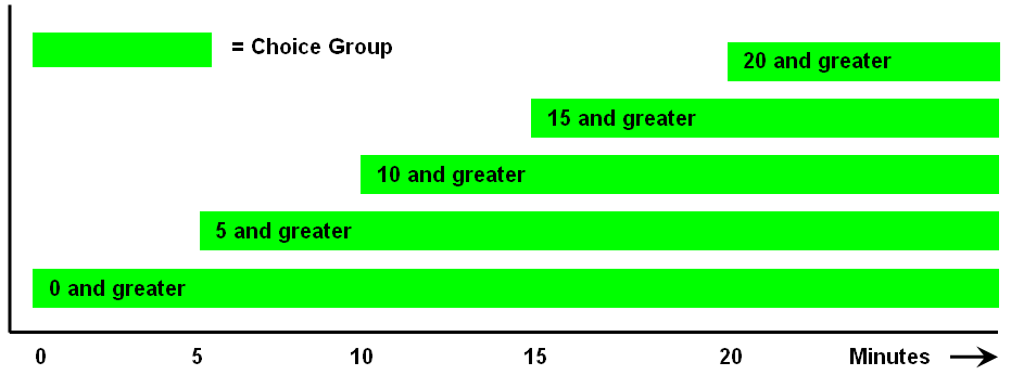

For predicting numeric values, Oracle RTD utilizes a method based on quantile regression and overlapping threshold techniques. The key component consists of choices whose values are equally spaced, overlapping numeric ranges. Users can configure the ranges as dynamic choices by supplying application parameters. For more details of these parameters, see Section 7.2, "Application Object."
As an example, with the application parameter Min Output set to 0, Spacing set to 5, and Max Output set to 20, the following dynamic choices are configured:
0 and greater
5 and greater
10 and greater
15 and greater
20 and greater
For each web session, as the session closes, the value for the total duration is passed to Oracle RTD. The Inline Service is configured to update the model for each of the choices that the session duration falls into. So if the session duration is 17 minutes, the choices, "0 and greater", "5 and greater", "10 and greater", and "15 and greater" will all have their associated models updated. This learning pattern is repeated for each session.
When a duration prediction is requested, based on session attributes, Oracle RTD provides a likelihood of occurrence for each of the choices. Oracle RTD then determines how many choices have a likelihood greater than a given minimum value - this minimum value is supplied by users as an application parameter Choice Likelihood Threshold, whose default value is 0.5.
For each choice where the likelihood is above the minimum value, Oracle RTD then applies the formula:
Prediction value of a numeric target = (Number of the dynamic choices that meet the minimum choice likelihood) * (Spacing between the choices) + (Minimum value for the target number)
Following the example, if four of the choices have a likelihood greater than the Choice Likelihood Threshold, the formula calculates the predicted value as:
4 (number of above threshold choices) * 5 (choice spacing) + 0 (minimum value) = 20
From this, it should be clear that the more narrow the spacing, the more precise the numeric prediction can be, assuming that there is enough data to learn on.

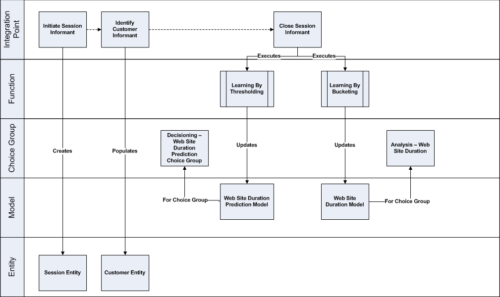

This section shows the workflows for the Numeric_Prediction_ECommerce Inline Service integration points and the Inline Service elements used during the processing of the integration points.
Figure 7-1 shows the workflow and elements associated with each informant in the Numeric_Prediction_ECommerce Inline Service. Note that the "learning" logic is included as part of the Close Session informant processing, which updates the following models:
The model that learns for numeric prediction against the Web Site Duration Prediction choice group
The model that learns for analysis against the Web Site Duration choice group
The processing for each informant shown in Figure 7-1 is as follows:
The Initiate Session informant creates the Session entity
The Identify Customer informant populates the Customer entity
The Close Session informant executes the following functions:
Learning by Thresholding
This passes the web duration to the Web Site Duration Prediction Model, which learns for numeric predictions against the Decisioning choice group Web Site Duration Prediction
Learning by Bucketing
This passes the web duration to the Web Site Duration Model, which learns for analysis against the Analysis choice group Web Site Duration
Figure 7-2 shows the workflow for the advisor Get Likely Web Duration in the Numeric_Prediction_ECommerce Inline Service.
The processing behind the Get Likely Web Duration advisor shown in Figure 7-2 is as follows:
The Get Likely Web Duration advisor calls the decision Select Likely Web Duration for Prediction, which uses the Decisioning choice group Web Duration Choice
The Decisioning choice group Web Duration Choice calls the function Get Numeric Prediction

The following informants are configured in the Numeric_Prediction_ECommerce Inline Service:
In the Numeric_Prediction_ECommerce Inline Service, these informants together with the advisor Get Likely Web Duration form a subset of the integration points found in the Base E-Commerce solution. They are used by the included loadgen scripts to create the simulated learnings that demonstrate the numeric prediction capabilities.
For more details about the Integration Point processing in the Numeric_Prediction_ECommerce Inline Service, see Section 7.6, "Integration Point Workflows."
The Initiate Session informant is called to initiate the Oracle RTD session and sends initial information regarding the customer interaction.

The Identify Customer informant is called to send information regarding the customer interaction that is collected during the web interaction.

The Close Session informant is called to close out the session and send in the final web duration value. It also contains the logic which calls the functions that update the appropriate dynamic choice models for numeric prediction.

Contains logic that calls the functions Learning By Thresholding and Learning By Bucketing. These functions update the choices groups for Web Duration in both the Analysis and Decisioning choice groups. |
