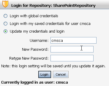

To select credentials for the current user, click the Manage | Content tab and select the third-party repository. After you select the repository, the Login Options button appears, as shown in Figure 8-2.
Click Login Options, select one of the following:
Click Login with Global Credentials to log in with the global credentials that you set up earlier. The third-party repository content accessible by the global credentials will be exposed to WLP. For more information on global identity, see "Configuring Security" in the Oracle Fusion Middleware Content Management SPI Development Guide for Oracle WebLogic Portal.
Click Login with my saved credentials for user xyz to log in to see the content this user is authorized to view. This option is only available if the third-party repository supports mapped identities (multiple user authentication). For more information, see "Configuring Security" in the Oracle Fusion Middleware Content Management SPI Development Guide for Oracle WebLogic Portal.
Click Update my credentials and login to enter a new user name and password for a mapped identity. You must have logged in at least once to select this option.
Click Login. See Figure 8-3.
Figure 8-3 Select Global or User Credentials to Log into the Third-Party Repository
User authentication persists across multiple portal sessions until you change it.
