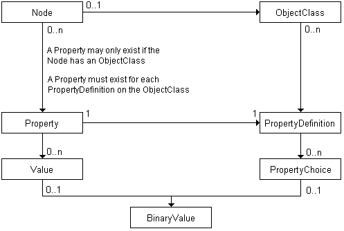

Figure 2-1shows an overview of the SPI data model.
Figure 2-1 Content Management Data Model Diagram
An ObjectClass defines the schema for a Node (that is, what kind of data a node of that type can contain). Besides the schema, the ObjectClass contains a name and ID that uniquely identifies the Node within the repository, plus an array of property definitions that describe the data (Properties) that a Node of that type can hold. For example, you could create a type "City" with property definitions for "population" (String) and "image" (binary).
ObjectClasses support, but do not require, type-inheritance. A type City may inherit from type Location, thus receiving property definitions from Location. Single inheritance is supported. Additionally, ObjectClasses support, but do not require, type nesting, which is a containment structure. This allows you to construct a hierarchy of Node data rather than a flat list of properties.
An ObjectClass contains a PropertyDefinition that defines the schema for a single Property that can exist on a Node of that objectClass. This is actually the schema for a named piece of data. The primary fields in it include:
Property name
Type (String, binary, boolean, and so on)
Single-valued or multi-valued
Read only
Mandatory (if it is required to have a value)
A PropertyDefinition may define a set of PropertyChoices that you can use to provide some predefined values. For example, a String property may have a set of property choices, one for each state.
A PropertyChoice can be demarcated as default. When a node is created, if the associated property has no value, it is created with the default PropertyChoice value.
A Node represents a set of external system data. A Node has a name, and you can address a node using a unique hierarchical path (ending with its name), or a unique ID.
If a node has a type, then you can include a set of Property values that hold external system data. The set of Properties available depends on the node's type (ObjectClass). For example, if Node myNode is of type City, and City has PropertyDefinitions for size and image, the myNode can have a property called size and another called image, with values for each of these properties.
