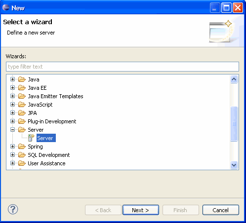

From the menu bar, select File > New > Other.
In the New dialog, expand Server in the Wizards tree and then click Server, if not already selected. (Figure 2-1)
Figure 2-1 The New Dialog for Selecting a Wizard
Click Next.

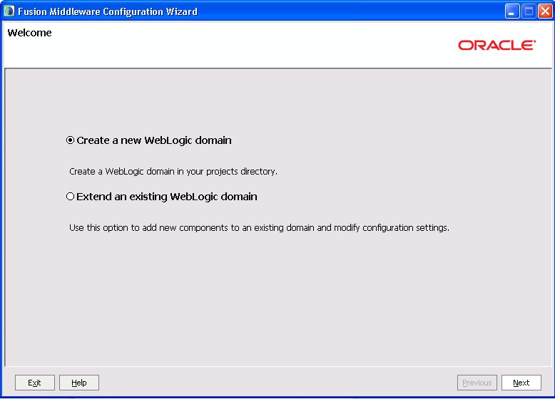

The Fusion Middleware Configuration Wizard displays, as shown in Figure 2-4.
Figure 2-4 Fusion Middleware Configuration Wizard
Follow the wizard prompts and enter the values shown in Table 2-1. Click Next as appropriate to continue through the wizard.

Welcome |
Create a new WebLogic domain (the default) |

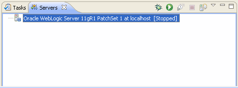

The new server displays in the Servers view in the Oracle Enterprise Pack for Eclipse workbench, and a Servers node is added to the tree in the Package Explorer view. Figure 2-5 shows the Servers view and the new server. If you don't see this view, select Window > Show View > Servers > Server.
For now, you do not need to start the server. Later in this tutorial, you will create a simple portal application, start the server, and run the portal application on the server.
Figure 2-5 New Server Displayed in Oracle Enterprise Pack for Eclipse

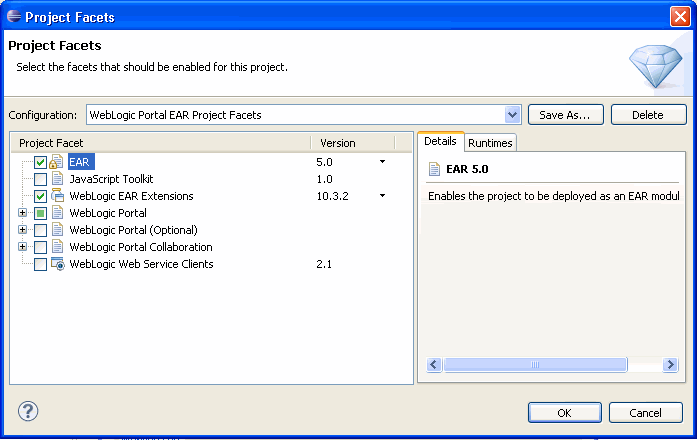

In the Configuration section, click Modify.
In the Project Facets dialog, verify that the WebLogic Portal node is selected in the Project Facets dialog, as shown in Figure 2-6.
The selections WebLogic Portal (Optional) and WebLogic Portal Collaboration are also available here. These selections are not needed for the tutorial; leave them unselected. For more information about what happens when you select these options, see the Oracle Fusion Middleware Overview for Oracle WebLogic Portal. For information about the Collaboration Portlets, see the Oracle Fusion Middleware Portlet Development Guide for Oracle WebLogic Portal.
Click OK to exit the Project Facets dialog.

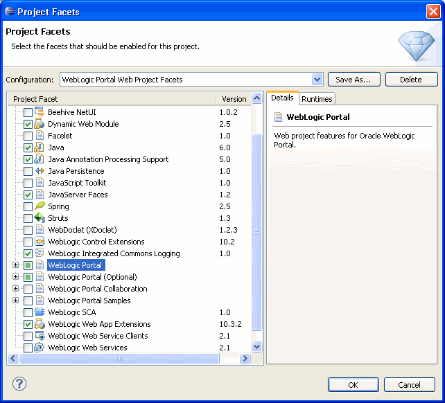

In the Configuration section of the dialog, click Modify.
In the Project Facets dialog, verify that the WebLogic Portal node is selected. Click OK to exit the Project Facets dialog.
Figure 2-10 Project Facets Dialog for Portal Web Project

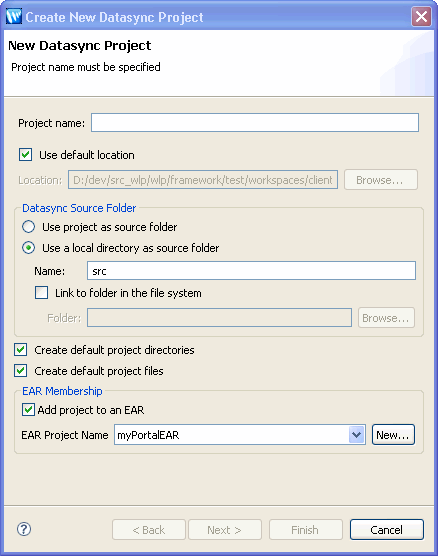

In Oracle Enterprise Pack for Eclipse, select File > New > Datasync Project.
In the Create New Datasync Project dialog, enter myData in the Project name field. (Figure 2-12)
In the other areas of this dialog, leave the default settings unchanged.
Figure 2-12 Create New Datasync Project Dialog

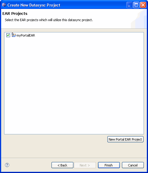

On the EAR Projects page, ensure the myPortalEAR checkbox is selected, as shown in Figure 2-13.
This associates the Datasync project with the Portal EAR project that you created previously.
Figure 2-13 Create New Datasync Project – EAR Projects Page
