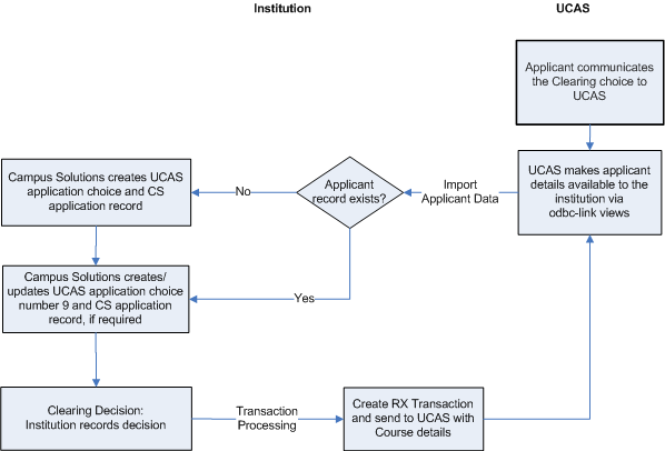

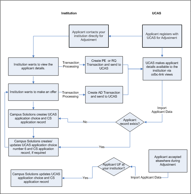

When the applicant responds to an offer and when his or her exam results are available, the institution confirms or rejects the conditional offer by comparing the applicant's exam results with the conditions. Campus Solutions enables you to import the exam results, match the results with the offer conditions and process Confirmation decisions.
An applicant who does not have an admission offer becomes eligible for Clearing. Also, an applicant can register with UCAS for Adjustment if he or she wants to apply for another course. Campus Solutions supports Confirmation, Clearing, and Adjustment processing for 2009 admissions cycle onwards.
The UCAS Admissions Guide and Decision Processing Manual provide more information about Confirmation, Clearing, and Extra. This guide and manual are available to subscribers from the UCAS website.

Scenario 1: Importing new Clearing applications (that is, application choice number 9 does not exist in the database)
For Clearing Application, enter the program action APPL (Application) and action reason CAP. For Clearing Acceptance, enter the program action ADMT and action reason CAC. For Clearing rejection, enter the program action DENY and action reason CR.
The Import Applicant Data Application Engine (SAD_UC_IMPAP) process imports UCAS Clearing application records from ivStarZ1. The imported UCAS Clearing application records have a choice number of 9.
If the Result value in ivStarZ1 is null for the Clearing application, the system creates a corresponding Campus Solutions application record with a program action of APPL and action reason of CAP.
If the Result value in ivStarZ1 is A for the Clearing application, the system creates a corresponding Campus Solutions application record with a program action of ADMT and action reason of CAC.
If the Result value in ivStarZ1 is R for the Clearing application, the system creates a corresponding Campus Solutions application record with a program action of DENY and action reason of CR.
For the new Clearing Campus Solutions application record that has a program action of APPL, you enter a decision A. After entering the decision you generate the RX transaction. In this case, the system updates the Campus Solutions application record with the program action of ADMT and action reason CAC.

Scenario 3: Importing Adjustment Applications
For the Adjustment Acceptance decision, enter a program action of ADMT and action reason of ADA.
The Import Applicant Data process imports UCAS adjustment (choice number 6 ) records from ivStarC. For applications, which the institution has already sent AD transactions to UCAS, the incoming decision value is U and reply value is F.
If the incoming decision value is not U, the system creates a corresponding Campus Solutions application record with a program action of APPL and the action reason that you had set up on the UCAS Application Import page.
If the incoming decision value is U and reply is F, the system updates the corresponding Campus Solutions application record with a program action of ADMT and action reason of ADA.
If the incoming decision value is U, reply is D, and Adjustment is not D, the system updates the corresponding Campus Solutions application record with the program action and action reason values that you had set up for Unconditional Decline on the UCAS Program Actions page.
For the new Adjustment Campus Solutions application record that has a program action of APPL, the institution generates an AD transaction. In this case, the system updates the Campus Solutions application record with the program action of ADMT and action reason of ADA.
Scenario 4: An applicant has been accepted by another institution through Adjustment. Your institution previously sent an unconditional offer or a confirmation acceptance to UCAS that the applicant has firmly accepted (the applicant has an application choice with a decision reply value of UF).
For the Adjustment Decline decision, enter a program action of DENY and action reason of ADD.
The Import Applicant Data process imports UCAS choice records from ivStarC.
If the incoming Adjustment value is D for an application choice that exists in your database, the process updates the decision-reply value from UF to UD. Also, the system updates the corresponding Campus Solutions application record with a program action of DENY and action reason of ADD.

To process Clearing applications for GTTR applicants:
Use the GTTR Enquiry Entry page to collect student contact address and exam results while the institution is negotiating with the student. The personal ID and application code values can be looked up from the cvgName UCAS view.
If the institution decides to accept or make a conditional offer to the student, enter the course, campus, entry year, entry month, transaction type (RX), decision (U or C) and decision maker.
Run the Transaction Processing process to generate and export the RX transaction to UCAS. The RX transaction must have a decision value.
Run the Import Applicant Data process to import the applicant data and application choices for the students you have sent RX transactions for.
The following diagram illustrates an example of the Clearing process flow:
Clearing Processing Flow Example
For processing Adjustment records (not applicable for GTTR applications):
Use the UCAS Enquiry Entry page to create Adjustment records and record RQ or PE transactions. Use this page to record the AD transaction.
Run the Transaction Processing process to generate and export the RQ, PE, or AD transaction to UCAS.
Run the Import Applicant Data process. The process imports the Adjustment application choice if you have sent an AD transaction. If you have sent a RQ or PE transaction, the process imports only Adjustment applicant data such as biographical data, and ivStarN, ivStarA and ivStarK data.
Use the UCAS Release to Clearing page to release an applicant into Clearing.
After your institution has accepted an applicant through Adjustment (that is, your institution has sent an AD transaction), the system updates the application choice to UF. If the applicant subsequently withdraws the applicant, then the institution may either release the application to clearing (RR transaction) or withdraw the applicant (RW transaction). Use the UCAS Release to Clearing page to record the RR transaction or use the UCAS Transactions page to record the RW transaction.
The following diagram illustrates an example of the Adjustment process flow:
Adjustment Processing Flow Example

Entering UCAS Clearing or Adjustment DetailsTo search for only adjustment records, select the Adjustment check box on the search page. To search for only Clearing records, clear the Adjustment check box on the search page.
Access the UCAS Enquiry Entry page (Student Admissions, UCAS Processing, UCAS Decision Processing, Enquiry Entry).
Use the Transaction Type field to record an RQ, PE, or RX transaction for a Clearing enquiry or the RQ, PE, or AD transaction for an Adjustment enquiry. Use the Decision field to enter A (Accept) or R (Reject). After you record the Clearing or Adjustment details, run the Transaction Processing process to generate the Adjustment or Clearing transactions to send to UCAS.
If you want to record a PE transaction, the UCAS Personal ID and UCAS Application Code fields are required (UCAS Course Code is optional).
If you want to record a AD transaction, the UCAS Personal ID, UCAS Application Code, UCAS Course Code, Entry Year, and Entry Month fields are required.
The UCAS Course Code field is required for RQ and RX transactions. Also, the Decision field is required for RX transaction.
