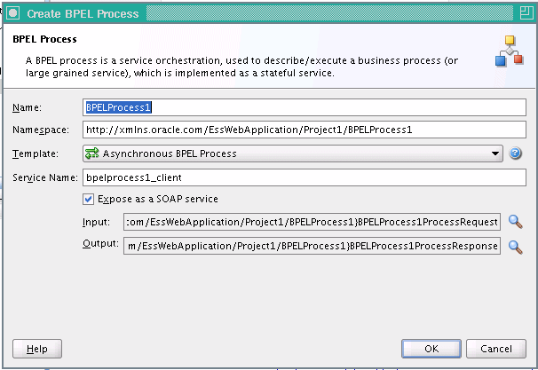

Now you need to add a BPEL Process to call the ESSWebService operations.
You need to add a BPEL process to use the ESSWebService.
To add a BPEL process to use the ESSWebService:
In the Application Navigator, in Project1 select composite.xml.
In the Component Palette, from the SOA dropdown list in the Service Components area select BPEL Process.
Drag-and-drop a BPEL process to the components swim lane. This displays the Create BPEL Process dialog, as shown in Figure 11-5.
Click OK. This adds the BPEL process to composite.xml, as shown in Figure 11-6.

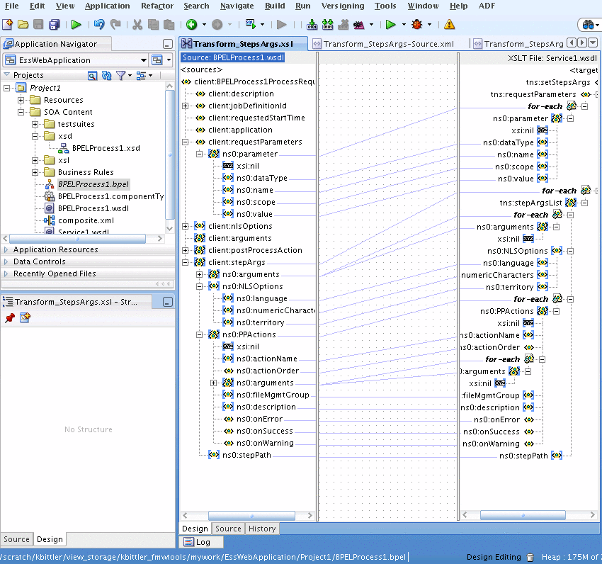

From the Component Palette, drag-and-drop a Transform Activity and place the activity before the setSubmitArgs. This transformation maps the BPEL flow input variable to the setSubmitArgs input variable.
Open the transformation activity. On the Transformation tab, in the Source area click the Add icon. This displays the Source Variable dialog.
In the Source Variable dialog select inputVariable and click OK.
In the transformation activity, on the Transformation tab, in the Target Variable field select setSubmitArgs_setSubmitArgs_InputVariable as the target.
In the transformation activity, on the Transformation tab, in the Mapper File field, click Add to create a new mapper file.
This creates a mapper file, as shown in Figure 11-31. Note that a "for-each" construct can be inserted by dragging an item from the XSLT Constructs area of the Component Palette.
The transformation tool does not create exactly what is needed. You need to edit the XSLT source. In the source, find the following mapping.

From the Component Palette, drag-and-drop a Transform Activity and place the activity before the setStepsArgs. This transformation maps the BPEL flow input variable to the setStepsArgs input variable.
In the transformation activity, on the Transformation tab in the Target Variable field select setStepsArgs_setStepsArgs_InputVariable as the target.
In the transformation activity, on the Transformation tab in the Mapper File field, click Add to create a new mapper file. This displays the XSL transformation file.
Create mappings as shown in Figure 11-34 using the mappings shown in Example 11-5.
Create an assignment activity. In this example, we want the requestParameters to come from the previous step, addPPActions, overriding what is in the transformation. There remainder of the input still comes from the BPEL flow input variable. Assign the requestParametersReturn/ns2:parameter of the addPPActions output variable to the requestParameters/ns2:parameter of the setStepsArgs input variable, just as in previous examples.
Example 11-5 Mapping Transformation for Set Steps Arguments Operation
