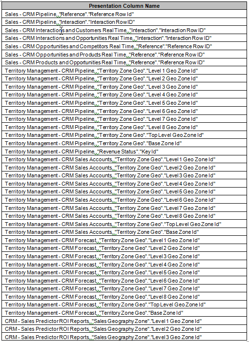

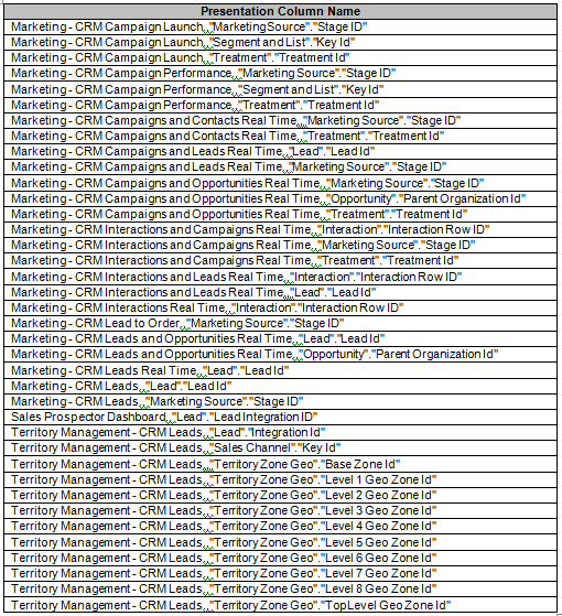

The following procedure describes the steps to improve the performance of Transactional Business Intelligence custom reports that contain the presentation ID column filter. See Figure 45, : ID Columns Exposed in the Marketing Presentation Catalog for the Marketing presentation and Figure 46, ID Columns Exposed in the Sales Presentation Catalog for the Sales presentation.
