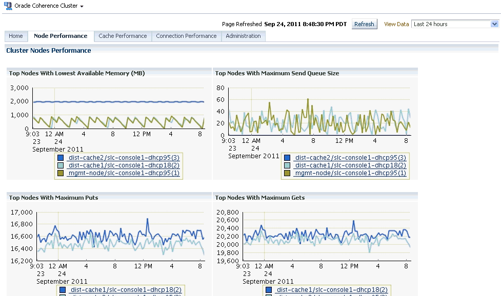

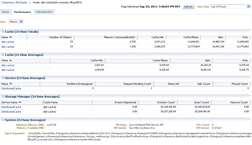

The Node Performance page displays a historical view of the metric data as it is stored in the repository. Click the Node Performance tab to view this page.
This page displays the performance of all the nodes in the cluster over a specified period of time. You can see charts showing the top nodes with lowest available memory, maximum send queue size, maximum puts, and maximum gets. By default, you can see the average performance metrics for the last 24 hours in all the Performance pages. If a target has been recently added, you can view real time data after one collection interval (between 5 to 15 minutes) since the 24 hour performance metrics will not be available. To view the real time charts, select one of the Real Time options in the View Data drop-down list in any of Performance pages. Using the View Data options, you can also view the average performance metrics for the last 7 or 31 days.The Node Performance page tab shows the performance of all nodes in this cluster. If you click on a link that shows multiple nodes like weak nodes, storage nodes, etc., the performance of the selected nodes will be displayed on this page. You can toggle between the two modes to see the performance of the selected nodes or all the nodes.

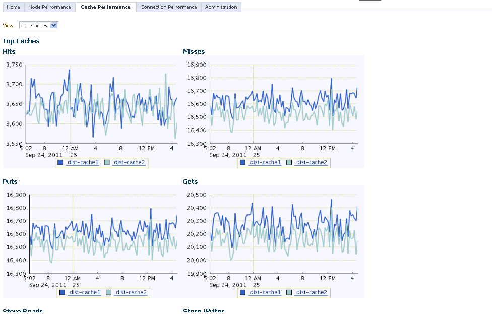

This page displays the cache related performance over a specified period of time. You can view the performance of the top caches or all the caches.
Select the All Caches option from the drop-down list to view the performance of all the caches in the cluster. If you select the All Caches option, you can see the total and average metric values over the selected period of time.

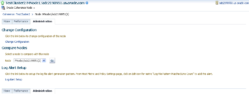

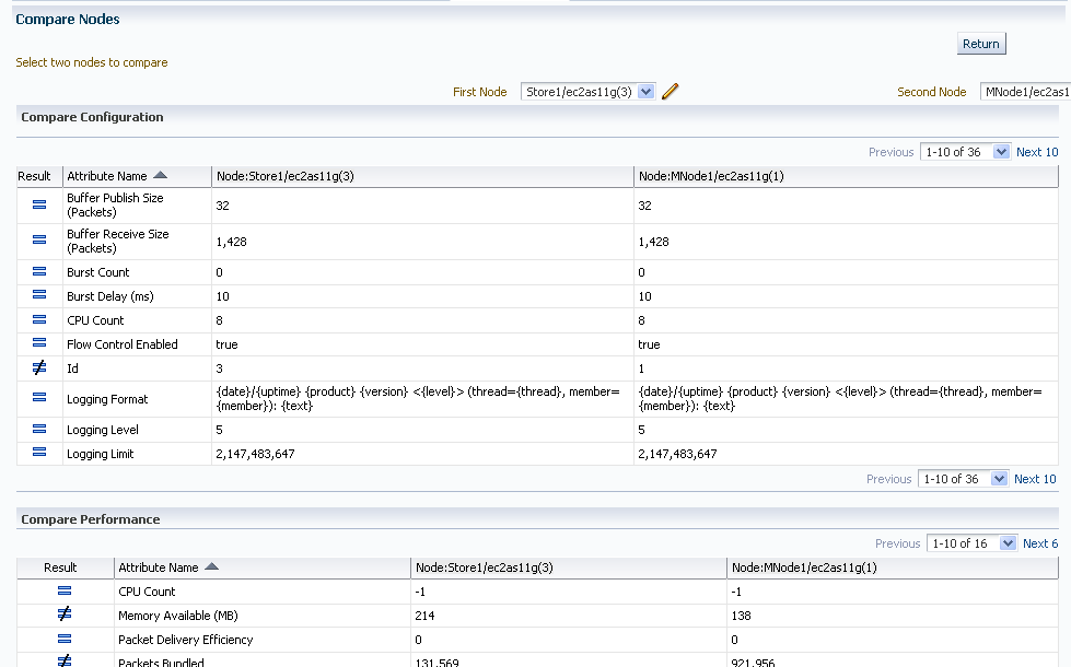

This page allows you to compare configurations of nodes, caches, and services.
On this page, you can do the following:
Change Configuration: Select an entity (node, cache, connection manager, connection, or service) for which the configuration needs to be modified and click Go. The Change Configuration page is displayed. Enter the new values and click Update to save the values and return to the Coherence Node Administration page.
Compare Two Entities: To compare two entities (node, cache, connection managers, connections, and services), select the first entity from the first drop-down list, the second entity from the second drop-down list and click Go. You will see the Details page where the details of the selected entities are shown side by side in a two column table.

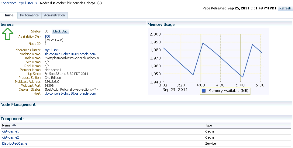

This page shows the details and controls of a specific selected node in the Coherence cluster.
This page contains the following sections:
General
Node ID: When a node becomes part of a cluster, an ID is automatically assigned to the node. This ID can be a new number or the number that was assigned to a Departed Node.
Machine Name: The name of the machine on which the node is running.
Note: You must set the machine name property when a node is started. To set the machine name, set the -Dtangosol.coherence.machine=HOST_NAME flag in the start coherence script. The HOST_NAME is the complete name of the machine on which the node is running. This allows you to associate the machine name with the Host Details page. See the Coherence documentation for more details on setting this flag.
Role Name: The role could be storage/data, application/process, proxy or management node.
Site Name: This indicates the location of the coherence node.
Rack Name: Name of the rack where the machine is located.
Member Name: The unique name assigned to the Member.
Process Name: Indicates the name of the process on which the node is hosted.
Up Since: The date and time from this node has been up and running.
Note: If a node has dropped out the cluster and rejoined the cluster, the period from which it last joined the cluster is displayed
Product Edition: The product edition this Member is running. Possible values are: Standard Edition (SE), Enterprise Edition (EE), Grid Edition (GE).
Memory Usage: The maximum memory and the available memory on this node are displayed as line graphs.
Node Management: In this section, you can click Stop Node to stop this node and click Reset Statistics to reset all the statistics for this node.
Components: The list of components and the type of each component in the cluster are displayed here. Click on the link to drill down to the Component Home page.
Metric Alerts: This table shows a list of all the metric alerts specific to this node.
Host Alerts: This table shows a list of alerts from the host on which this node is running.

Node ID: An ID is automatically assigned to any node that is part of the cluster. This can be a new number or a number that belongs to a Departed node.
Outgoing Byte Backlog: The number of outgoing bytes in the backlog.
Outgoing Message Backlog: The number of outgoing messages in the backlog.
Up Since: The date and time from which the connection manager instance is up.
Bytes Received: The number of bytes received per minute.
Bytes Sent: The number of bytes sent per minute.
Metric Alerts: This table shows a list of all the metric alerts specific to this connection manager.
Host Alerts: This table shows a list of alerts from the host on which this connection manager instance is running.
Entity level performance pages give detailed views of the performance of this particular entity. For nodes and caches, there are two views - Charts and Metrics. You can select the option from the View drop-down list.
This page displays the performance of a specific node over a specified period of time. You can view either the charts or the actual metrics by selecting the appropriate option from the View drop-down list. If you select Charts option, you can see the average gets, puts, memory available, send queue size, and publisher and receiver success rates over the selected period of time. If you select the Metrics option, you can see the total and average metric values over the selected period of time.
This page shows the following details:
Charts: The following line graphs are displayed for the selected nodes on this page.
Puts: This graph shows the average number of put() operations per minute. Click on the graph to drill down to the Puts Sum Delta metric page.
Gets: This graph shows the average number of get() operations per minute. Click on the graph to drill down to the Gets Sum Delta metric page.
Memory Usage: This graph shows available memory for the node over a period of time. You can use this graph to view trends by setting different real time and historical time options. Click on the graph to drill down to the Memory Available (MB metric page).
Send Queue Size: This graph shows the Send Queue Size for this node. The Send Queue Size indicates the number of packets that are scheduled for delivery. This includes both packets that are to be sent immediately and packets that have already been sent but are waiting for acknowledgement. Click on the graph to drill down to the Send Queue Size metric page.
Publisher and Receiver Success Rates: This graph shows the Publisher and Receiver success rate percentage. Click on the graph to drill down to the corresponding metric pages.
Metrics: The metric values for the selected period are displayed.
Cache: This section shows the total and average metrics values for all the caches running on this node.
Name: Name of the cache.
Tier: Indicates whether it is the front or back tier.
Loader: Responsible for reading/writing data from the underlying database.
Number of Objects: Shows the number of objects in the cache.
Memory Consumed: The amount of memory used by the cache in units.
Cache Hits: The average number of cache hits in the last 24 hours. A cache hit is a read or a get() operation.
Cache Misses: The average number of cache misses in the last 24 hours.
Gets: The average number of get() operations in the last 24 hours.
Puts: The average number of put() operations that have occurred during the specified period.
Service: This section shows the average values for all the services running on this node.
Name: The unique name assigned to the service.
Partitions Endangered: The total number of partitions that have not been currently backed up.
Status HA: The high availability status of the service. This can be Machine-Safe, Node-Safe, or Endangered.
Thread Count: The number of threads in the service thread pool.
Task Count: The average number of tasks that have been executed in the specified period.
Storage Manager: This section shows all the storage manager instances running on this node.
Service Name: The unique name assigned to the service.
Cache Name: The name of the cache.
Events Dispatched: The total number of events dispatched by the Storage Manager per minute.
Eviction Count: The number of evictions from the backing map managed by this Storage Manager caused by entries expiry or insert operations that would make the underlying backing map to reach its configured size limit.
Index Info: An array of information for each index applied to the portion of the partitioned cache managed by the Storage Manager. Each element is a string value that includes a Value Extractor description, ordered flag (true to indicate that the contents of the index are ordered; false otherwise), and cardinality (number of unique values indexed).
Insert Count: The number of inserts into the backing map managed by this Storage Manager. In addition to standard inserts caused by put and invoke operations or synthetic inserts caused by get operations with read-through backing map topology, this counter is incremented when distribution transfers move resources `into` the underlying backing map and is decremented when distribution transfers move data `out`
Remove Count: The number of removes from the backing map managed by this Storage Manager caused by operations such as clear, remove or invoke.
System: This section shows the system information for this node.

This page displays the performance of a specific cache over a specific period of time. You can view charts showing the number of cache hits, misses, store reads, and store writes. You can also see the aggregated totals and average metric values over the selected period of time.
The following graphs are displayed:
Number of Objects: This graph shows the number of objects in the cache.
Memory Consumed (Units): This graph shows the amount of memory consumed by the cache per minute.
Hits: This graph shows the number of cache hits per minute.
Misses: This graph shows the number of cache misses per minute.
Puts: This graph shows the total number of put() operations per minute.
Gets: This graph shows the total number of get() operations per minute.
Store Reads: This graph shows the total number of load operations per minute.
Store Writes: This graph shows the total number of store and erase operations per minute.

You can drill down to the Administration page for a specific node, cache, connection, or connection manager. You can change configuration for a specific entity, or compare configurations for two entities in the cluster.
You can compare the configurations for a node, cache, service, or connection manager target. The comparison details between the two selected entities are shown in a four column table. The first column shows the comparison result. The second column shows the attribute being compared and the values of the attribute being compared are displayed in the last two columns. When an attribute value is the same for both the entities, you would see an “=” in Result column. Otherwise, you would see a non-equal sign in Result column. The figure below shows the Compare Nodes page.
Enterprise Manager monitors log files for the occurrence of user specified patterns to check for abnormal conditions. Log files are periodically scanned for occurrence of one or more perl patterns and an alert is raised when the pattern occurs during a given scan.
You can set up each Coherence node to log all messages into a log file on the host on which the node is running. You must use a specific naming pattern in the log file name to ensure that it is monitored. To configure the log file monitoring criteria, follow these steps:
From the Targets menu, select Middleware, then click on a Coherence cluster target.
Navigate to the Administration page of the node for which the Log file alerts need to be configured.
Click the Log Alert Setup link. The Metric and Policy Settings page of the host on which the Coherence node is running is displayed.
Select Metric with Thresholds in the View drop-down box and search for the Log File Pattern Matched Line Count metric.
Click the pencil icon in this row to navigate to the Edit Advanced Settings: Log File Pattern Matched Line Count page.
Click Add to add a row to the Monitored Objects table.
In the Log File Name field, specify the name in the format <coherence_cluster_target_name>_<Node_name>_<....any other optional names>.log.
Specify the pattern to be matched for or ignored in the Match Pattern in Perl and Ignore Pattern in Perl fields. Lines matching the ignore pattern will be ignored first, then lines matching specified match patterns will result in one record being uploaded to the repository for each pattern.
Enter the Critical and Warning thresholds for this metric and click Continue. You will return to the Metrics and Collection Settings page. Click OK to update the metric.
Any alerts generated will be displayed in the Coherence Log Alerts section in the Cluster Home page.
