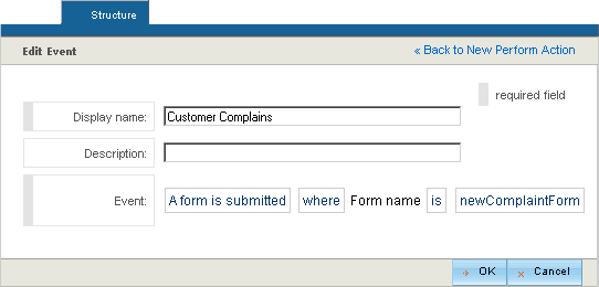

To add an event to an action, perform the following steps:
The image below shows the event editor with some sample data:
