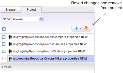

Most assets that you create or edit in the Business Control Center must be added to a project so that they can be versioned and deployed. To see the assets that have been added to the current project, display the Project tab, as shown below:
When you create an asset, for example a user segment, the asset is automatically added to the current project, and the label “NEW!” appears next to the asset in the Project tab. The new asset also appears in the Browse tab for this project. The asset will be published to the live Web site when the project is deployed. The asset is also added to the versioning system.
