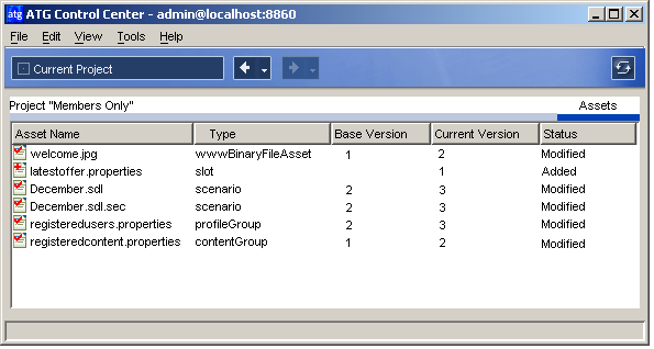

  6. Choose Publishing > Current Project. The ACC lists project assets:
    The following information is listed for each asset:
    • Name
    • Asset type—for example, scenario
    • Base version number (the checked-in version)
    • Current version number (the working version)
    • Status, one of the following:
      Added: The asset has a working version only (the asset has not yet been checked into the versioning system). If an asset has the status Added, a plus sign appears next to it in the list.
      Modified: The asset has at least one checked-in version. The status is shown with a check mark next to the asset.
      Deleted: The asset is in the process of being deleted. The status is shown with an X next to the asset. Assets appear as Deleted for one of the following reasons:
      You used the Browse tab in the Business Control Center to select an asset for deletion, and you specified this project as the one to delete the asset (assets can be modified only if they are added to a project first).
      You delete an asset through the ACC. The asset is removed from the list in the window you used to remove it, but it appears as Deleted in the Publishing > Current Process list. This behavior occurs because an asset must be added to a project before any changes, including deletion, can be made to it.
