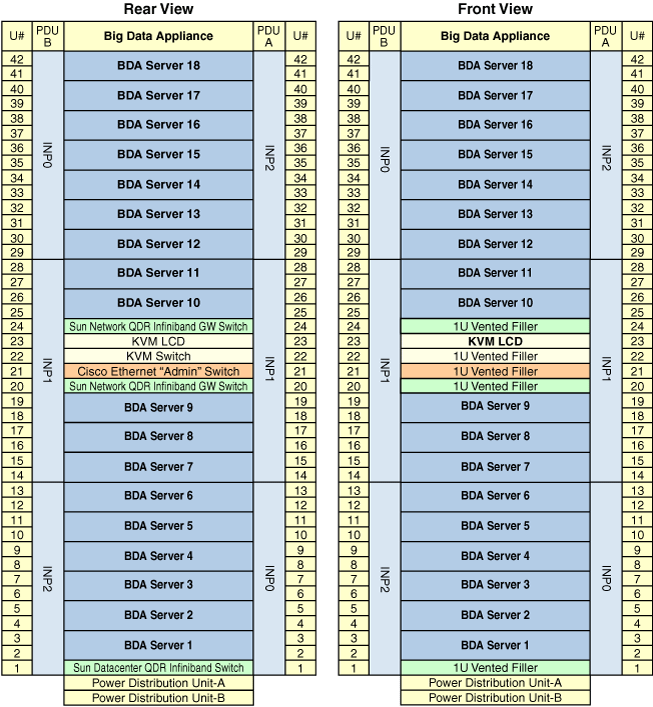

Figure B-1 shows the front and rear layout of Oracle Big Data Appliance Rack.
Figure B-1 Rack Layout of Oracle Big Data Appliance Rack

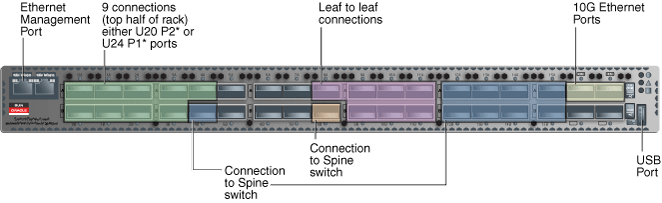

Figure B-2 Sun Network QDR InfiniBand Gateway Switch Ports
