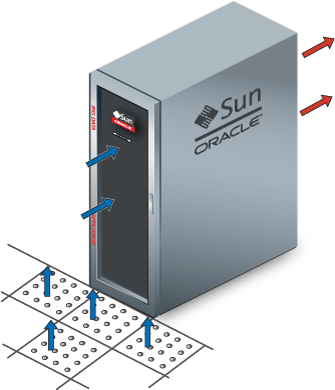

Airflow through Oracle Big Data Appliance is from front to back. Refer to Table 2-1 for information on cooling and airflow.
Studies show that temperature increases of 10 degrees Celsius (15 degrees Fahrenheit) above 20 degrees Celsius (70 degrees Fahrenheit) reduce long-term electronics reliability by 50 percent.Excessive internal temperatures may result in full or partial shutdown of Oracle Big Data Appliance.

If the rack is not completely filled with components, then cover the empty sections with filler panels. Gaps between components can adversely affect air flow and cooling within the rack.

Use perforated tiles, approximately 400 CFM/tile, in front of the rack for cold air intake. The tiles can be arranged in any order in front of the rack, provided that cold air from the tiles can flow into the rack. Inadequate cold air flow could result in a higher inlet temperature in the servers due to exhaust air recirculation. Oracle recommends four floor tiles for Oracle Big Data Appliance
Figure 2-5 shows a typical installation of the floor tiles for Oracle Big Data Appliance in a typical data center.
Figure 2-5 Typical Data Center Configuration for Perforated Floor Tiles
