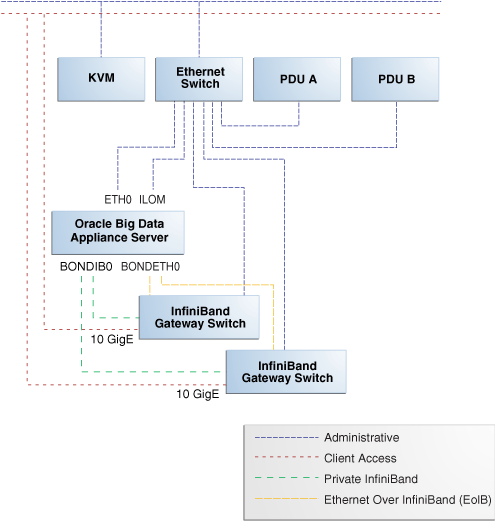

To deploy Oracle Big Data Appliance, ensure that you meet the minimum network requirements. Oracle Big Data Appliance uses three networks. Each network must be on a distinct and separate subnet from the others. These are the network descriptions:
Administrative network: This 1 Gigabit Ethernet (GigE) network connects to your existing administrative network and is used to administer all components of Oracle Big Data Appliance. It connects the servers, ILOM, and switches connected to the Ethernet switch in the rack.
There are three uplinks to the administrative network:
From the Ethernet switch in the rack
From the KVM switch in the rack
From each power distribution unit (PDU).
Network connectivity to the PDUs is required only if the electric current is monitored remotely.
Each server has two network interfaces for administration. One provides administrative access to the operating system through the ETH0 Ethernet interface, and the other provides access to the Integrated Lights Out Manager through the ILOM Ethernet interface. Oracle Big Data Appliance is delivered with the ETH0 and ILOM interfaces connected to the Ethernet switch on the rack. Do not use the ETH0 interface on the servers for client network traffic. Cabling or configuration changes to these interfaces are not permitted.
Client access network: This 10GigE network connects the servers though the gateway switches to your existing client network and is used for client access to the servers. Client applications access the software through this network using Single Client Access Name (SCAN).
There are two Sun Network QDR InfiniBand Gateway Switches in the rack. Each switch supports 1 to 8 connections for client access for a total of up to 16 client network connections. For failover, you must have at least one connection from each switch and scale up according to your requirements for loading data and providing client access.
InfiniBand private network: This network connects the servers using the InfiniBand switches on the rack and the bondib0 interface. This non-routable network is fully contained in Oracle Big Data Appliance and does not connect to your existing network. This network is automatically configured during installation.
All networks must be on distinct and separate subnets from each other.The servers are configured on the network as follows:
ETH0: Provides access to the operating system using the administrative network.
BONDETH0: Provides access to the server using the client access network. The SCAN addresses are defined on this interface.
ILOM: Provides access to the Integrated Lights Out Manager (ILOM) using the administrative network.
Figure 3-1 shows the network diagram. Use the preinstall-checkip.sh script to verify the cable connections when cabling Oracle Big Data Appliance to the existing network. See "Checking for Network Errors".
Figure 3-1 Network Diagram for Oracle Big Data Appliance
