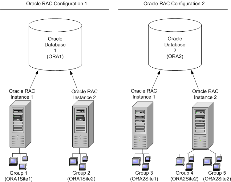

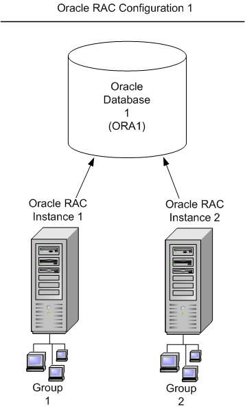

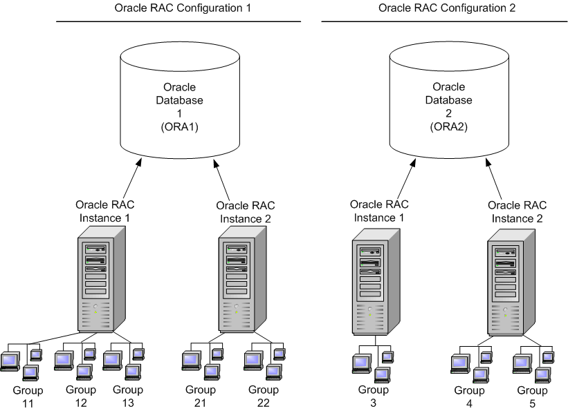

TUXRACGROUPS
The TUXRACGROUPS environment variable specifies the groups that are associated with a particular RAC configuration, and will disallow sending service calls in the same transaction to two or more groups identified as different instances of the same RAC configuration.
WARNING:
If the TUXRACGROUPS environment variable is used, it must be set on all machines in a configuration, and must have the same sets of groups specified in the same order on all machines.
If this restriction is not followed, then inconsistent sets of groups can be included within a transaction. The coordinating group will notice the inconsistency at commit time, roll back the transaction, and send an error message to the userlog.
TUXRACGROUPS Syntax
The TUXRACGROUPS environment variable is used to define Oracle RAC group configurations. Its syntax is as follows:
TUXRACGROUPS="G1,G2,…,Gm;H1,H2,…,Hn[;…]:I1,I2,…,Io;J1,J2,…,Jp[;…][:…]"
Comma (,) separated list
Used to specify groups in the same instance of an Oracle RAC configuration. Multiple groups from a comma separated list can be used together in the same transaction.
Semicolon (;) separated list
Used to specify sets of groups in different instances of an oracle RAC configuration. Groups from different RAC instances from the same RAC database configuration cannot be used together in the same transaction.
Since the purpose of the TUXRACGROUPS environment variable is to specify groups associated with different instances of the same Oracle RAC configuration, all applications using the TUXRACGROUPS variable should have at least one semicolon in the environment variable value.

Example 1: Simple Configuration
TUXRACGROUPS="G1;G2"
Figure 6‑1 shows a simple Oracle RAC configuration.
In this example, there is one Oracle database, (ORA1), two Oracle RAC instances with 1 group per each instance.
The same transaction request to both GROUP1 and GROUP2 cannot be sent because they access database services through different instances that map to the same Oracle RAC database configuration.
Figure 6‑1 (ORA1) Simple Configuration
Example 2: Oracle RAC Single Instance with Multiple Groups
TUXRACGROUPS="GROUP1;GROUP2:GROUP3;GROUP4,GROUP5"
Figure 6‑2 shows an example of adding multiple groups to a single instance.
In this example, there are two Oracle databases: ORA1 and ORA2. ORA1 offers machine-specific services ORA1SITE1 and ORA1SITE2, and ORA2 offers machine-specific services ORA2SITE1 and ORA2SITE2. The objective is to assign an approximately equal number of transactions and configure the same services to the groups associated with each instance of an Oracle RAC configuration.
The same transaction request to both GROUP1 and GROUP2 cannot be sent because they access database services through different instances that map to the same Oracle RAC database configuration. The same applies to GROUP3 and GROUP4 or GROUP3 GROUP5, the same transaction cannot be sent to both these groups.
GROUP4 and GROUP5 both access the same database service of the same Oracle RAC database configuration, so these groups would be permitted together. GROUP1 and GROUP4 would be permitted together, because they access different RAC database configurations. If there is also a GROUP6 in this configuration, it would be permitted with any other group, because GROUP6 is not an Oracle RAC group.
Figure 6‑2 (ORA2) Single Oracle RAC Instance with Multiple Groups

Example 3: Multiple Oracle RAC Instances with Multiple Groups
TUXRACGROUPS="GROUP11,GROUP12,GROUP13;GROUP21,GROUP22:GROUP3;GROUP4, GROUP5"
Figure 6‑3 shows an example of adding multiple groups to multiple instances.
This example is similar to the previous example — except that GROUP11, GROUP12, and GROUP13 are all associated with the first RAC instance of the first RAC configuration, and GROUP21 and GROUP22 are both associated with the second RAC instance.
If the first service call in a transaction in this configuration goes to GROUP12, then it would be possible to send other service calls in this transaction to GROUP11, GROUP12, or GROUP13, but not to GROUP21 or GROUP22.
If a transactional service call is made to a service that is not advertised in any permitted groups but is available in one or more prohibited groups, the result is:
tperrno is set to TPENOENT
tperrordetail is set to the new value TPED_GROUP_FORBIDDEN
Figure 6‑3 Multiple Oracle RAC Instances with Multiple Groups

For Oracle 10gR2, it is much simpler to configure transaction recovery. The database services specified in the OPENINFO string for each group associated with Oracle RAC should be declared in Oracle as DTP services.
For example, in Listing 6‑6, GROUP1 accessed Oracle via service ORA1SITE1 and GROUP2 accessed Oracle via service ORA1SITE2. In Oracle 10gR2, service ORA1SITE1 should be declared with DTP=TRUE, with preferred instance SITE1, and with available instance SITE2. Service ORA1SITE2 should be declared with DTP=TRUE, with preferred instance SITE2, and with available instance SITE1. A similar process should be followed for groups GROUP3, GROUP4, and GROUP5.
By declaring different preferred instances, the application will be able to get the benefit of load balancing during normal operation when both instances are available.
The setting of the TUXRACGROUPS environment variable will ensure that different instances of the RAC configuration are not combined in the same transaction in order to obtain optimal performance. If one of the RAC instances goes down, Oracle will transfer the DTP service to the non-preferred instance while maintaining transactional integrity.
When using Oracle 10gR2 DTP services, it is not necessary and is not recommended to configure Oracle FAN, use TMS_rac_refresh(1) or set the XARETRYDURATIONSECONDS or XARETRYINTERVAL environment variables.
