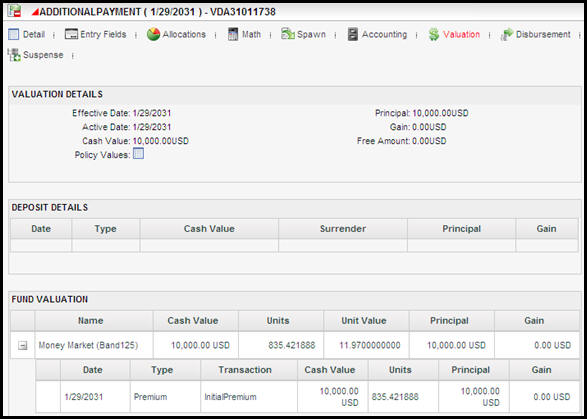

The activity's valuation, if calculated using a <Valuation> element, will exist in memory and its values will appear on the Valuation tab of the Activity Results screen. Accessing the activity's valuation can be accomplished by using the ‘Valuation:’ syntax. The activity's effective date will always be the activity's valuation date.

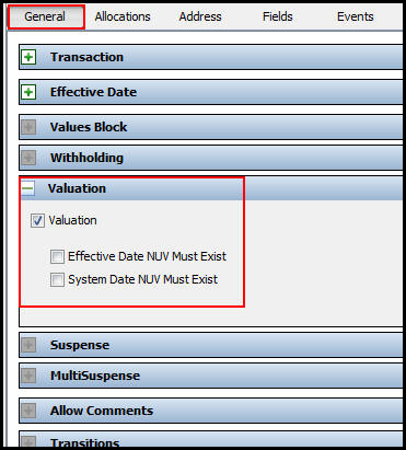

In the Rules Palette, the Valuation Engine is configured in the General pane.
The Valuation checkbox should be checked if the transaction will need valuation to run.
This MUST be checked if Assignments are configured.
This MUST be checked if you want to pull values from the Valuation XML.
If this box is checked, the Unit Values (NUVs) as of the activity’s Valuation Date must be present in order for the activity to process at all. If there are no Unit Values, the system displays an error message stating NUV’s Missing (Effective Date).
If the box is checked, Unit Values as of the System Date must be present in order for the activity to process at all. If no Unit Values are present, the system displays an error message stating NUV’s Missing (System Date).
If the box is unchecked for a variable product and NUV’s do not exist for the System Date, but Unit Values are present for the Valuation Date, the activity will process in its entirety, except for the calculation of any Gain/Loss. The Activity List screen will display a lightning bolt icon next to the activity with a status of Gain/Loss Pending until Unit Values are added for the System Date. After Unit Values have been entered for the System Date and either the lightening bolt is clicked again or Cycle is run, the Activity Status will change to Active and Gain/Loss will be calculated.
For Fixed products, this should never be checked.
Transaction Valuation in Activity Detail Window in OIPA
