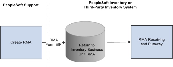

Regardless of RMA type, some processing steps are shared by all RMAs that are created in PeopleSoft Support:
A customer calls the agent and requests an RMA.
The agent opens a new or existing case for the customer and creates an RMA in PeopleSoft Support.
When the agent saves the RMA, the system uses the Return Material Authorization EIP (referred to as RMA Form EIP in the diagram) to stage the RMA for processing in the inventory business unit that has been defined on the RMA as the location to send the returned material.
The customer physically returns the material to the inventory business unit.
In PeopleSoft Inventory, or your third-party inventory system, receipt of the returned material is recorded and the RMA is closed in the inventory system.
Your inventory system handles the receipt status management for RMAs.
This diagram illustrates the basic RMA processing flow from PeopleSoft Support through PeopleSoft Inventory or a third-party inventory system:
We discuss this information in more detail in the Financials/Supply Chain Management documentation for defining general options.

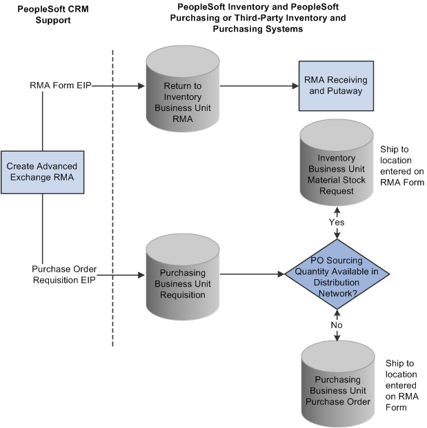

With the advanced exchange RMA type, you can create a replacement order for the customer at the time that you create the RMA. Specify the replacement item or items on the RMA line.
The replacement order can include any of the active items in your system. When you save the RMA form, the system stages the RMA in your inventory system using the Return Material Authorization EIP and creates a requisition request for the replacement order in your purchasing system using the Purchase Order Requisition EIP (referred to as PO Requisition EIP in the diagram).
The system obtains the ship to address for the customer's replacement order from the RMA form.
We discuss this information in more detail in the documentation for enterprise integration points, understanding the EIP catalog.
See PeopleTools 8.52: PeopleSoft Integration Broker Administration PeopleBook
This diagram illustrates the advanced exchange RMA processing flow:
Advanced exchange RMA processing flow
The Purchase Order Requisition EIP enables you to requisition a replacement for the customer at the time that the advanced exchange RMA is created.

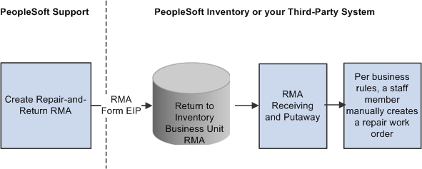

You create repair-and-return RMAs when a customer sends an item back to you for repair. As delivered, PeopleSoft CRM does not offer repair depot functions. However, if your business includes repair services, you can use the repair-and-return RMA option in conjunction with your business process rules. The repair-and-return RMA processing is similar to return-and-replace RMA processing:
A person creates an RMA for a customer in the specified return-to business unit in your inventory system.
A staff member, in the facility where the item needing repairs is sent, records the receipt of the RMA in your inventory system.
The staff member creates a work order for the repairs, according to your business rules, and delivers the item to the appropriate staff for repair work.
The work order should include the ship to address for the customer who appears on the RMA form and the RMA number (to facilitate RMA tracking across your enterprise).
The material is shipped back to the customer using the address information from the RMA when the repair work is complete.
This diagram illustrates the repair-and-return RMA processing flow:
Repair-and-return RMA processing flow
For repair-and-return RMAs, repair work orders are manually created per your business rules when the returned material is physically received from the customer.
You create a return-to-stock RMA for a customer who is returning material with no need for a replacement. Typically, the customer has received the wrong shipment or been shipped too much quantity. The process flow for a return-to-stock RMA is identical to the basic RMA processing flow.
We discuss this information in more detail in the documentation for receiving and putting away stock and transferring stock between business units.
See PeopleSoft Inventory 9.1 PeopleBook.
