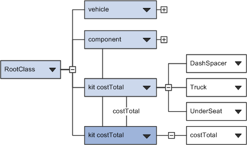

To display relationships in the Model Structure view, click a participating object, such as a class. Red lines appear, connecting all participants. The relationship name appears on the connecting lines. Double-clicking the name opens the relationship editor.
The costTotal relationship between subclasses cost and kit and subclasses cost and component
When an object is selected, the Attributes tab shows the relationship or expression name and the path to the file containing the relationship.

Click to jump to top of pageClick to jump to parent topicEditing Summation Relationships
Attribute summation uses a dialog box similar to that of the resource provider relationship. It simply lists all of the classes that contain the attribute that you want to sum. The total is placed in a domain member attribute on the class specified in the Attribute to store sum in field. The sum automatically appears in the Model Tester.
Note. The attribute that is used to store the sum must be different from the attribute that is totaled, or it must be a child of a class that is not participating in the summation relationship.
A summation constraint cannot calculate quantity. Instead, you must use an expression that uses sumWithQty( ). An expression can use sum() or the + operator to accomplish the same task as this relationship. An expression has the additional capability to sum external variables.
