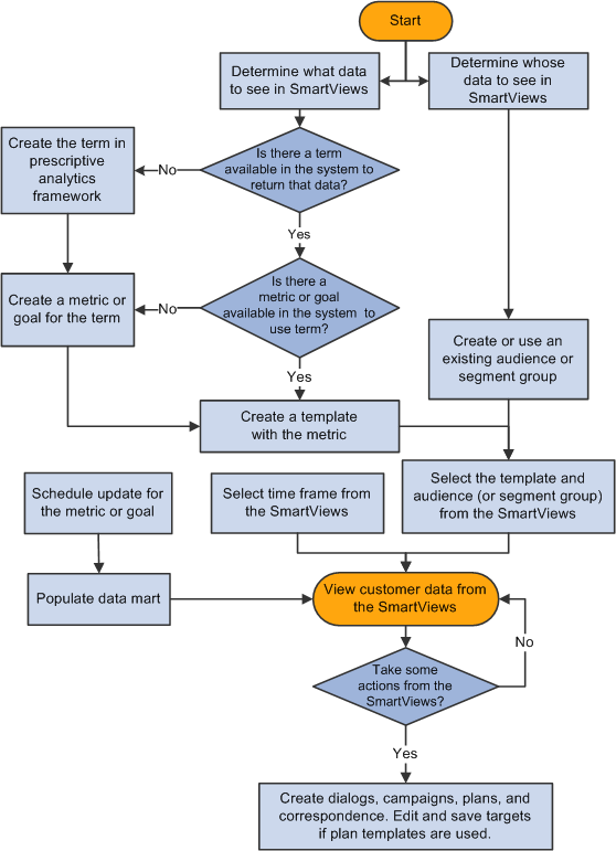

This diagram illustrates the high-level process of setting up templates and customers and using these components in SmartViews:
Process flow for setting up and using SmartViews
