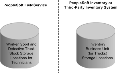

This diagram shows how the good and defective storage locations are manually defined in two systems:
Defining truck storage locations for technicians in PeopleSoft CRM and Inventory (or another third-party inventory) systems
In order for material movement transactions that are initiated from the Time Material Expense page within the service order to be successfully recorded in the inventory system, the truck stock storage location (good or defective) that is defined for any field service technician (including an inventory business unit, a storage area, and up to four storage levels) must correspond to a valid storage location that is defined for that specific inventory business unit in the inventory system.
