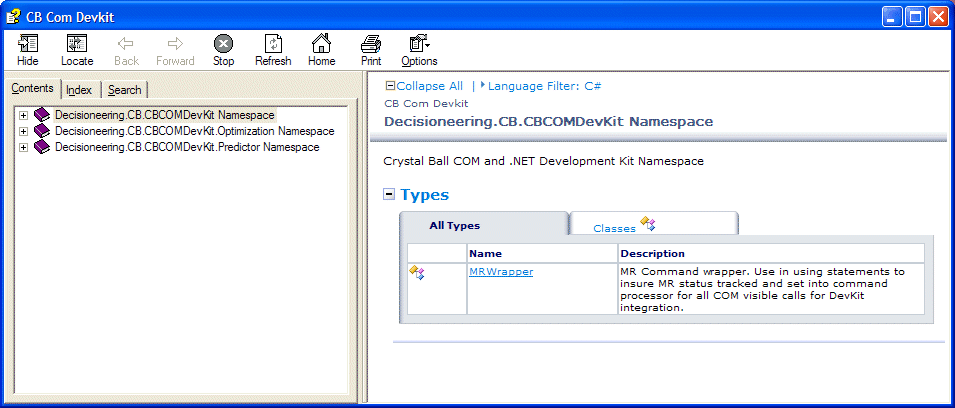

When you first open CB Com Devkit.chm, three namespaces appear in the navigation pane (Figure 1, CB Com Devkit.chm with Three C# Namespaces). These namespaces are only used in C# code, not Visual Basic (VBA) code. However, if you are using VBA, they indicate which classes are used for OptQuest automation (.Optimization) and which are used for Predictor (.Predictor). When writing VBA code, you omit .Optimization or .Predictor as shown in the code examples included in this Developer's Guide.
Figure 1. CB Com Devkit.chm with Three C# Namespaces
CB COM DevKit.chm initial screen with .Optimization and .Predictor namespaces

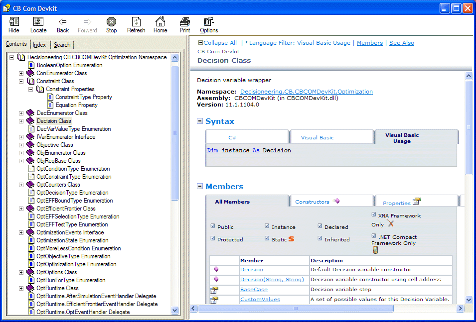

CB Com Devkit.chm is generated from actual OptQuest Developer Kit code and has a development language filter to help you with your code. The default is C#. You can change to Visual Basic or Visual Basic Usage (for code snippet examples). The topic in Figure 2, CB Com Devkit.chm Opened to the Constraint Properties Topic for OptQuest has two collapsible headings, Properties and See Also. Other topics, such as Decision Class, shown in Figure 3, CB Com Devkit.chm opened to the Decision Class topic., have an additional Syntax heading.
The Syntax tabs are linked to the Language Filter menu in the help window. In Figure 3, CB Com Devkit.chm opened to the Decision Class topic., the language filter is set to Visual Basic Usage. Since the Visual Basic Usage filter shows sample Visual Basic code, a code snippet appears on the tab.
Figure 3. CB Com Devkit.chm opened to the Decision Class topic.
This example shows the Decision Class tab, which displays the Syntax and Members.
If you click the Visual Basic tab, Visual Basic appears in the Language Filter menu and the Visual Basic tab is selected in the Syntax tab group.
