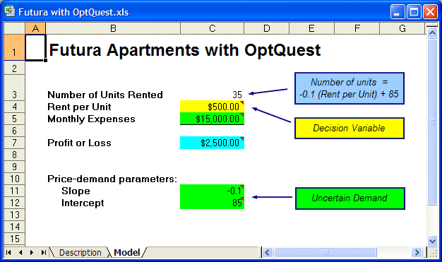

    The Futura Apartments worksheet opens as shown in Figure 12, Futura Apartments worksheet.
    Figure 12. Futura Apartments worksheet
    In this spreadsheet, the rent is set to $500, where:
    Number of units rented = -.1(500) + 85 = 35
    and the total profit will be $2,500. If all the data were certain, the optimal value for the rent could be found using a simple data table. However, in a more realistic situation, monthly operating costs and the price-demand function parameters (-.1 and 85) are not certain (probability distributions for these assumptions are already defined for this example). Therefore, determining the best rental price is not a straightforward exercise.
