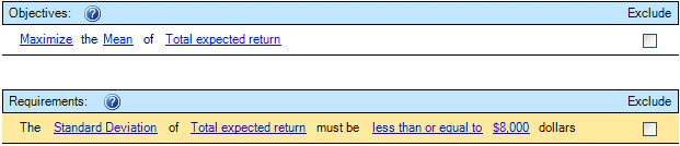

  3. Click Add Requirement.
    This creates a new row in the Requirements area:
    When you click Add Requirement, a new row is created in the Requirements area.
  4. In the new row, click Mean. In the list, select Standard Deviation.
  5. Click greater than or equal to and change it to less than or equal to.
  6. Then, click 100 and change it to 8000.
    This adds a requirement that the standard deviation of the expected returns must be less than or equal to $8,000 for a solution to be considered feasible.
    Figure 29. Objectives panel with the new requirement
    Objectives panel with the new requirement.

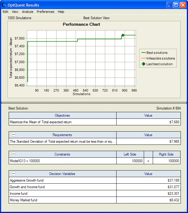

  7. Click Run.
The new results are shown in Figure 30, Portfolio allocation optimization results with risk.
Figure 30. Portfolio allocation optimization results with risk
As shown in Figure 30, Portfolio allocation optimization results with risk, after several hundred simulations, OptQuest found a solution that meets the requirement well. The standard deviation of Total Expected Return is just below $8,000. The objective value, though, is now significantly lower than the previous solution without the limit on risk (Figure 26, OptQuest Results window — Best Solution view, Portfolio Allocation model).

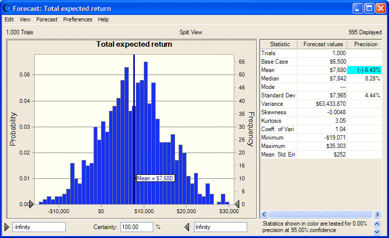

If you return to the Portfolio Allocation model and display the resulting forecast chart in Split View (Figure 31, Best optimization solution with lower risk requirement), you can see that the new values appear. The standard deviation of Total Expected Return is just less than $8,000 and the coefficient of variability is slightly greater than 1.
Figure 31. Best optimization solution with lower risk requirement
Best optimization solution with lower risk requirement.
