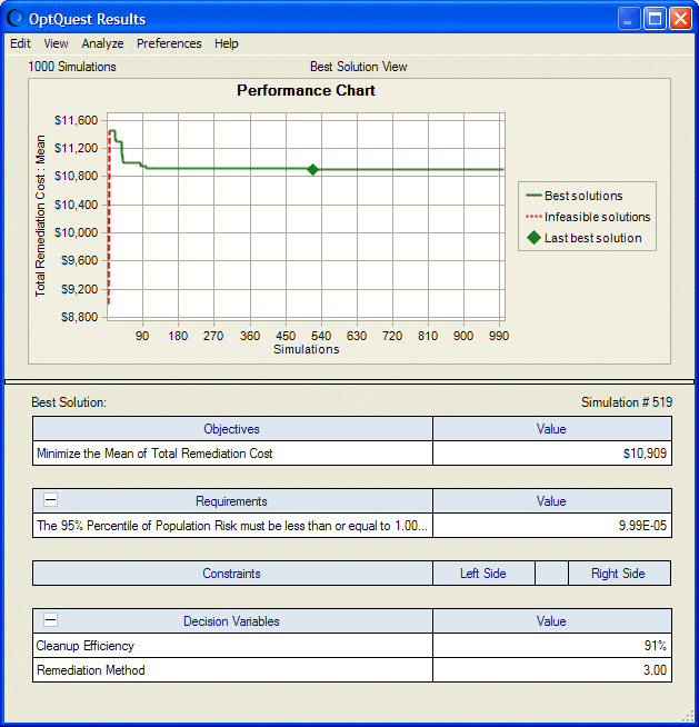

  4. On the Options panel, click Advanced Options and select Automatically stop after 500 non-improving solutions.
  5. Run the optimization.
The results are shown in Figure 42, Groundwater cleanup optimization results, following. The solution in Figure 42, Groundwater cleanup optimization results minimizes costs at $10,909 while keeping the risk level at 9.99E-5, rounded.
Figure 42. Groundwater cleanup optimization results
Groundwater cleanup optimization results.

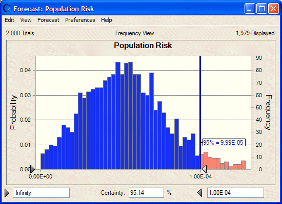

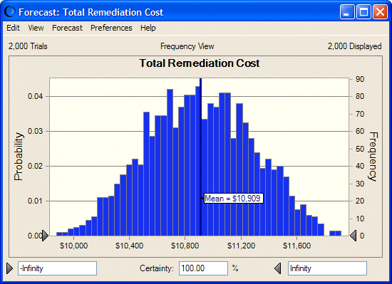

The distributions for the total remediation cost and the population risk are shown in Figure 43, Groundwater cleanup total remediation cost forecast chart and Figure 44, Groundwater cleanup population risk forecast chart.
Figure 43. Groundwater cleanup total remediation cost forecast chart
Groundwater cleanup total remediation cost forecast chart.
Figure 44. Groundwater cleanup population risk forecast chart
