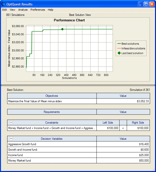

    The results appear in Figure 51, Portfolio Revisited Multi-objective Optimization Results. Mean minus std dev is maximized at $3052.33 and fund values are as follows:
    • Aggressive Growth = $16,400
    • Growth and Income = $8,600
    • Income = $25,000
    • Money Market = $50,000
    After reviewing the results, close Portfolio Revisited.xls without saving it.
    Figure 51. Portfolio Revisited Multi-objective Optimization Results
    Portfolio Revisited results table
