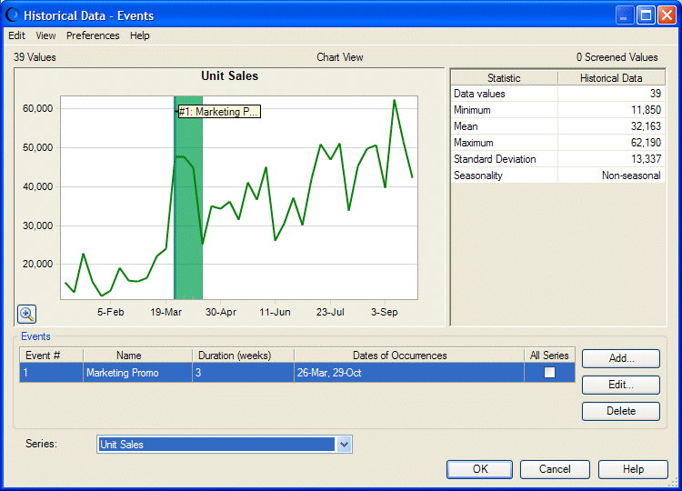

To add, edit, delete, and view events, in Data Attributes, click View Events. The Historical Data - Events dialog opens (Figure 4, Historical Data - Events Dialog with an Event Added).
Historical Data - Events contains:
Series chart, upper-left corner—Plots historical data values for the selected series; defined events are indicated by vertical bars.
Click the Zoom button at the bottom of the chart beneath the y-axis to contract and expand the x-axis and show more or fewer time periods per unit of length.
Events list—Lists events by number, name, duration, and date. A check box indicates whether the event applies to all series or just the selection. Use the buttons to add, edit, or delete events. For details, see the following:
Note: | Events cannot overlap. At least one time period must not be defined as an event. If more than 10 percent of the historical values are defined as events, predictive accuracy can be affected. A warning message is displayed, but you can still choose to complete the forecast. |
Series list, lower-left corner—Lists all the data series in the selected spreadsheet cell range. The currently selected series appears in the chart.
Statistics, upper-right corner—Lists the following: number of historical data values, minimum value, mean value, maximum value, standard deviation of values, and the number of time periods in a cycle, such as 12 months in a year.
