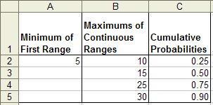

For a connected series of continuous uniform ranges specified using cumulative probabilities, use a three-column format with the common endpoints of the ranges in the second column and the cumulative probabilities in the third column. The first column is left blank except for the minimum value of the first range, beside the maximum in the second column (Figure 128, Connected Continuous Uniform Ranges). Be sure to check Probabilities Are Cumulative in the Load Data dialog.
Figure 128. Connected Continuous Uniform Ranges
This figure displays a connected, continuous, uniform range.

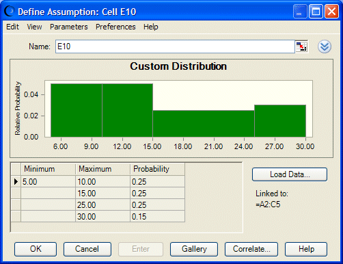

Figure 129, Connected Continuous Uniform Ranges After Loading shows the custom distribution created by loading the data illustrated in Figure 128, Connected Continuous Uniform Ranges.
Figure 129. Connected Continuous Uniform Ranges After Loading
This figure displays connected, continuous uniform ranges after loading.
