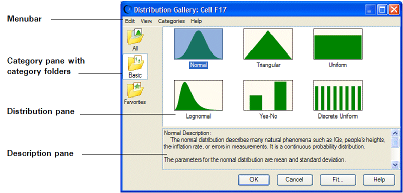

    For each selected cell or cells in the selected range, Crystal Ball displays the Distribution Gallery dialog (Figure 13, The Distribution Gallery with Basic category Selected).
    Figure 13. The Distribution Gallery with Basic category Selected
    The Distribution Gallery with the Basic Category selected, showing the menubar, Category pane with category folders, Distribution pane, and the Description pane.
  3. In the Distribution Gallery, select the distribution you want from the gallery. The Basic category contains several frequently used distributions. Click All to view all distributions shipped with Crystal Ball. For details, see Using the Crystal Ball Distribution Gallery.
    Alternately, click the Fit button to fit a distribution to historical data, as described in Fitting Distributions to Data.
    For more information on the Distribution Gallery, see Distribution Gallery Window.

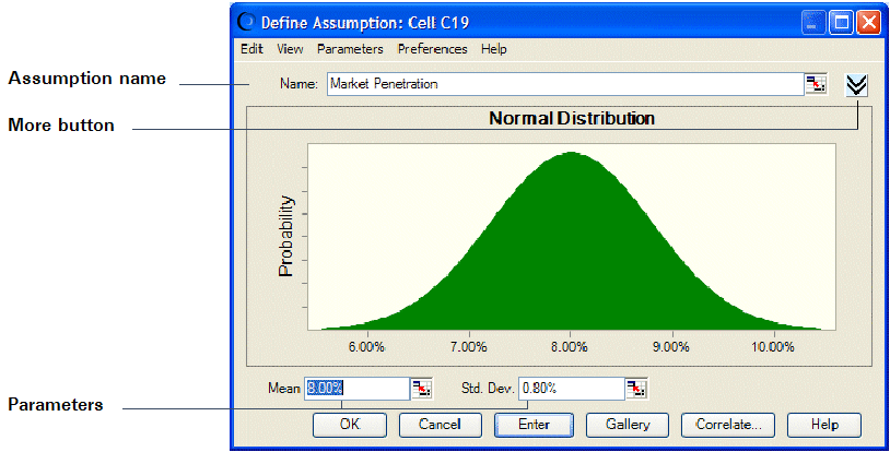

  4. When the Define Assumption dialog opens (Figure 14, Normal Distribution), type in a title and the parameters for the distribution. The parameters can be either numeric values or cell references.
    Figure 14. Normal Distribution
    The Define Assumption dialog, displayed a Normal distribution.
    To change the distribution type, click Gallery to return to the Distribution Gallery and then select another distribution.

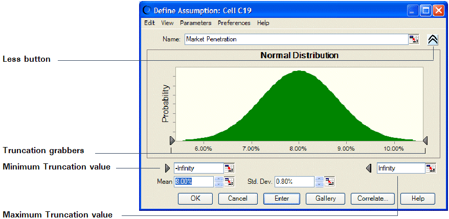

  5. To see more information, click the More button, More button, near the Name field.
    More information is displayed in the Define Assumption dialog as shown in Figure 15, The Define Assumption Dialog, Expanded.
    Figure 15. The Define Assumption Dialog, Expanded
    The expanded Define Assumption dialog showing the loss button, truncation grabbers, and the minimum and maximum truncations values.
    In the expanded Define Assumption dialog, you can:
    • Enter truncation minimum and maximum values in the minimum and maximum truncation fields (just below the distribution, accessible by tabbing).
    • Use the truncation grabbers to truncate the value range.
    • Use numeric spinners (arrows beside the field) to adjust parameter settings.
    • Click the Less button, Less button, to hide the minimum and maximum value fields and truncation grabbers. (For more information about truncating distributions, see Truncating  Distributions.)
